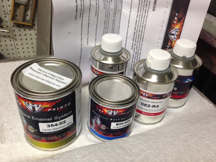

I received the Bacchus Olive paint from VMR
