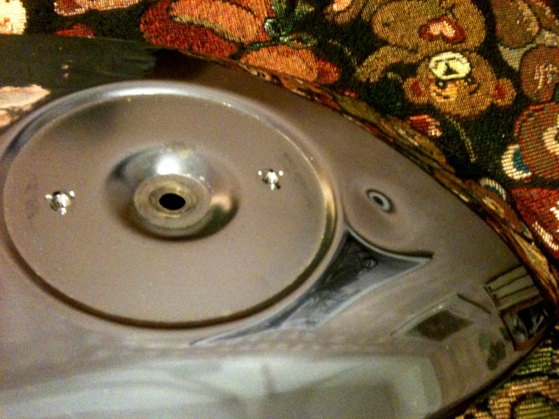

UPS is definitely not my favourite company at the moment!
I've decided that my Bomber should have a Bomber tank from the beginning so I won a right hand Bomber tank chrome panel with a small ding on Ebay for a very reasonable price recently. UPS has tried to deliver the package last week when I was not at home but left a note that they would make a new attempt on Friday. I had nothing important to do so I took the day off to wait for the package. On Friday evening I had still not got my package but on the online tracking I could read that they had tried to deliver but that nobody was at home. Apparently the delivery driver was in a hurry to get home early this Friday evening.
Today I got a message that the package can be picked up at the UPS package central...at the Sturup Airport which is a 60 km round trip! Since I don't own a car I jumped on the bike and went to get my package. Sure, it was a great ride on beautiful roads but totally unnecessary if the delivery driver had done his job.
Looks almost like new...
...except for a small ding that I'll try to fix.
