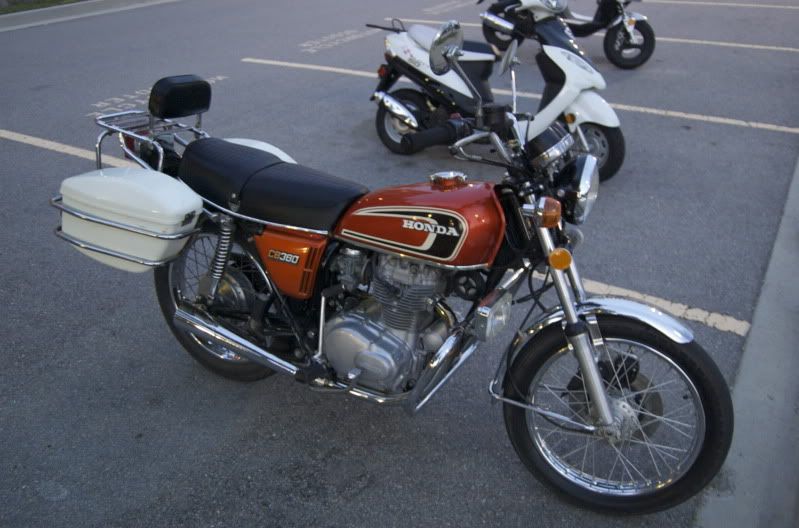

Hey guys I'm new here but have already learned a bunch from this site about my bike.
This is my first street bike, I used to ride dirt bikes when I was younger though. But on to the bike,
Its a 1974 Cb360 and had 7200 miles on it when I got. It had been driven a bit every month by the original owner until he passed away. I picked it up from his best friend who bought it a year ago. It spent its whole life inside until the first night I owned it. I got it off Ebay and may have overpaid a bit but for the condition it was in I couldn't get a better deal around here. The bike is in great shape but does need a little maintenance.
First things first I need to get the valves adjusted, only problem is one bolt is stripped on the cover. I'm going to have to figure out how to get that off and replace it. Also I need to get the gas tank cleaned out and sealed.
Anyways, on to the pictures.
It came with a wind screen on it along with the saddle bags/luggage rack/sissy bar. Haven't decided if I'll keep the bags but the wind screen is gone (couldn't hardly see through it and it was useless at blocking any wind since I'm a good 6 in taller than it was) and the sissy bar thing will go soon.
Let me know what you think!

Yep, me and a few friends were drooling over that bike when it sold. :cool: Nice score, I am envious.
If it were me, I'd keep the bags--those are pretty rare, and I think they look great. Pretty useful, too. The sissy bar, highway bar, etc., can all go, though.
