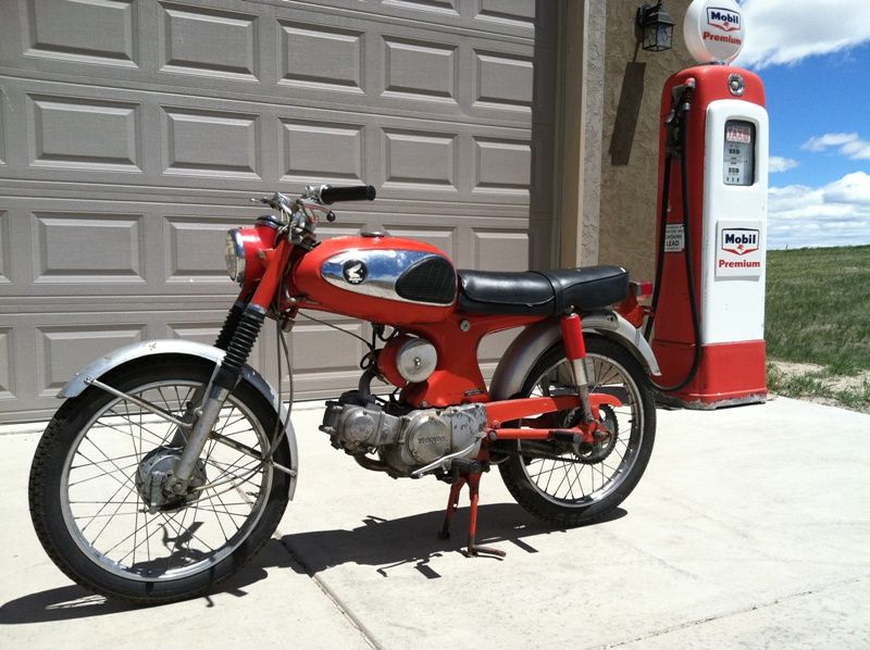

I've had this '65 Honda S90 for a couple of years now and was thinking about riding it a bit this summer. But decided to go straight into a restoration instead.
When I found it in a barn, it was complete and original for the most part. Which is one of the things I put a high value on. Having just over 1800 miles on the odometer was also a big plus, however is was cosmetically challenged to the point I wouldn't be able to consider it a survivor.
Here is what it looked like when I got it home

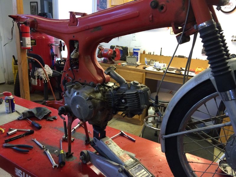

Here I'm getting ready to lower the motor.
The whole tear down process is only a few hours with most time taken up by snapping pics for later reference and bagging and labeling all the fasteners.

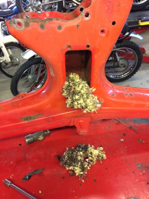

Since this is hardly my first rodeo with S90's, even riding them in the '60s for that matter, it has been my experience that any barn find S90 will have been the home for mice inside the frame. This one didn't disappoint me in that aspect either. Sometimes I think I could get hantavirus just looking at a dusty old S90.
With chewed up wiring pulled out of the frame, it's time to get rid of the rest of the nest.

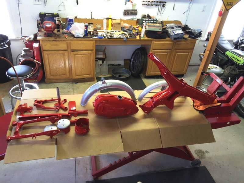

Laid everything out to make sure it was all there. Some assembly may be required
Since I also have another red '65 S90 parts bike with really close VIN to this one, I was able to change out some of the crustier parts.

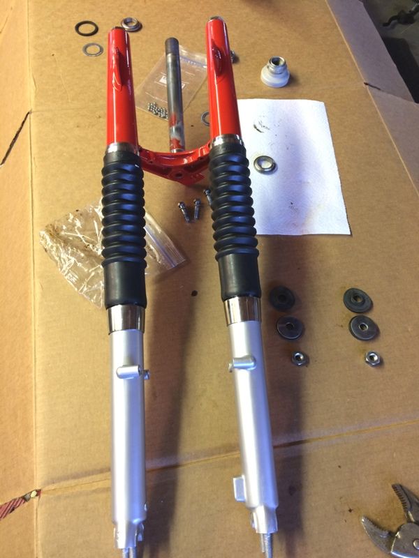

Here I've already redone the front shocks and boots then pulled them through the lower tree, then put on the fork ears and top bolts to keep them from collapsing/sliding down.

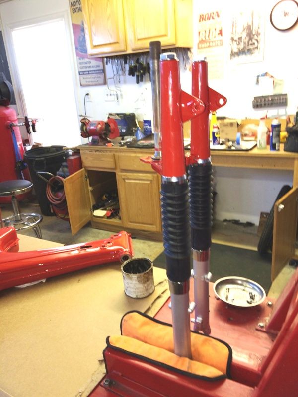

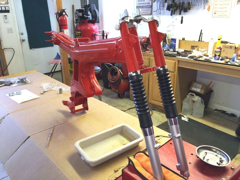

I realize everybody has there own method of assembly, and mine are quite different depending on model I'm assembling as well. Here I've set the forks with lower tree into the wheel clamp to hold vertical so I can place the 21 balls onto the lower bearing race with a little grease. (this image didn't come out as clear as I expected:

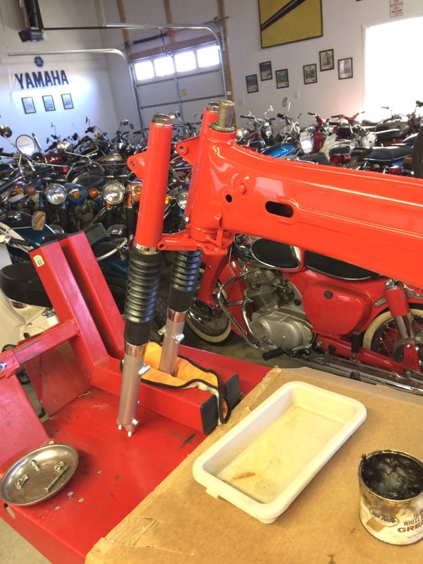

In this position it is easy to lift the empty frame and set the frame neck right down on the lower bearing.

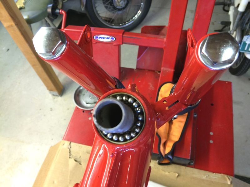

Once the frame is in place it's time to put the remaining 20 ball's (upper bearing is just slightly smaller than the bottom) on the upper race.
Here you can see it's ready for the upper tree after the top bearing is in place.
Not that I've got the bearing adjusted the upper tree goes on and then it's just a matter of putting in the pinch bolts and redoing the top bolts after putting in some fresh fork oil.
