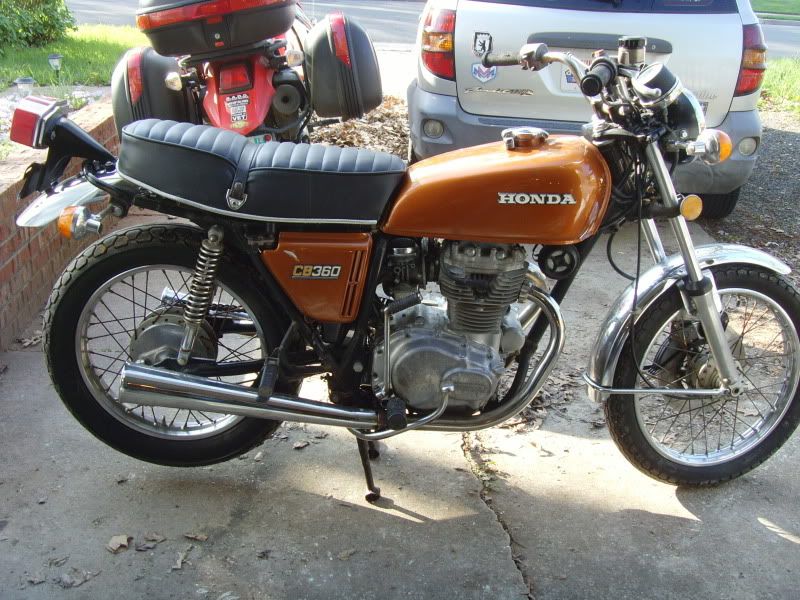

OK, I finally decided to make today the day I officially start the resurrection of my 74 360.
Here she is the day I brought her home:

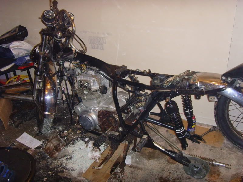

and here she is right now:
Many more to follow. I need to order those damn coils already, and some rubber bits as well. I played around with this all day, I am really looking forward to getting her back on the road. Now if I could just get my KLR out of the way. :roll:
90 Posts
Yeah, she runs, but I think the right side doesn't fire, thus the need for new coils. Just replacing electrical crap and control cables. Not digging into the engine unless I have to. The oil drain plug is going to be a challenge, feels like it is welded on. :x
