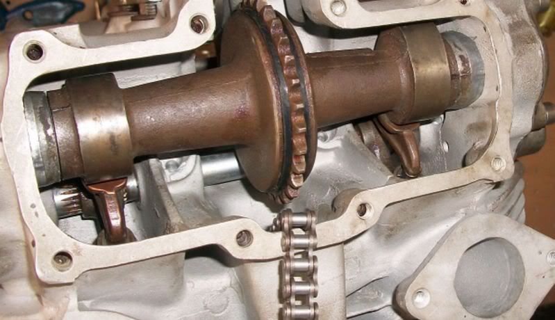

About to set the cam timing using Bills' excellent article. I have the cams in and covers on to make sure everything fits, had to add shims to the intake cam. Cams on the intake and exhaust are not touching the lifters and the engine is on the LF mark on the rotor.
My question is when do I run the cam chain through and link it together - now or before I install the cams?
No, get everything in place (alternator marks, cam marks), then rivet the chain together
Usually I put the link in at the 3 o'clock position on the intake cam sprocket - that will give your tool a chance to maybe fit.......
Your photo looks good (at least the intake) - make sure the exhaust cam mark is on spot, then get the cam chain up on the sprocket and rivet.
You'll WANT to be on the "LT" mark, NOT the "LF".......And the right exhaust valve SHOULD be under pressure (touching at the lifter and camshaft)...... You have to install the cams in order to link the chain ON them.............Please re-read Bill's process ENTIRELY, and understand it it before proceeding....

Its on the LT mark, my typo error. Any trick to getting the chain up into the top of the head/top sprocket?
It goes under the center guide sprocket, and I use a wire hanger with a hook to pull/guide it through......
