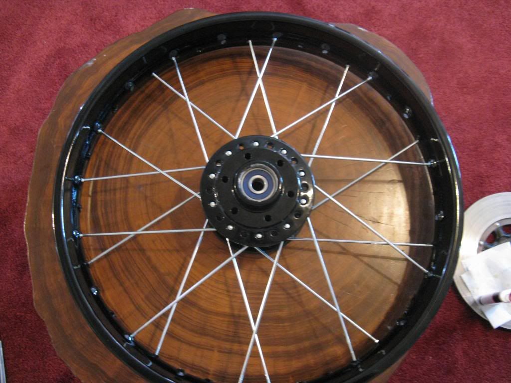

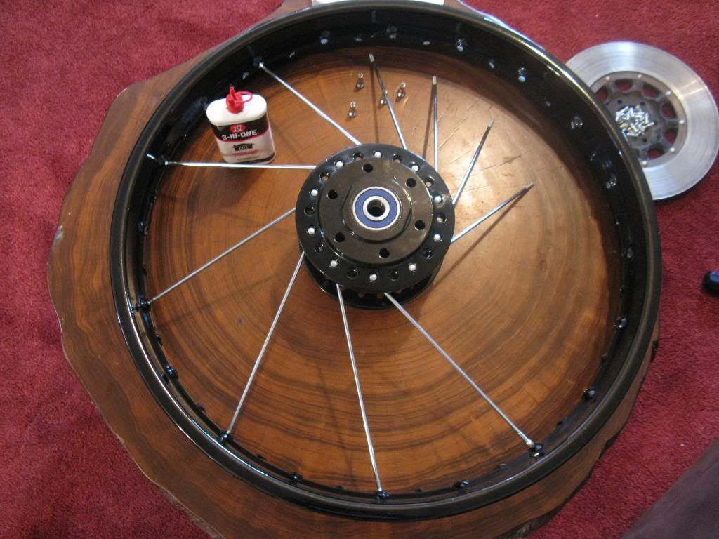

I laced up my new spokes to my newly powder coated wheels the other day. The rear wheel went great! took about 10-15 min to get it all assembled. The front wheel however I've taken back apart twice to check that everything is as it should be but I think I'm still having problems.
I laced it up and some of the spokes are sticking through the rim further than others. The spokes are the correct length and I'm 95% sure I have the pattern correct but maybe I don't. The only spokes that are coming through too far are the inner ones. I've looked at pictures of complete wheels and I think my pattern is right but if some see's that it's not please let me know. The only other thing I could think of is... does the rim itself have a forward direction? In other words would it change anything if I relaced it just the same but with the hub flipped around? any help is appreciated
-Nathan
And here is the problem-
http://i307.photobucket.com/albums/nn288/nathanhouse82/CB450
/IMG_1949.jpg
It's a '70 CB450
Since the "long" ones seem to be in a pattern, you must be putting them back in wrong.
You took plenty of photos first, right??
Supposed to be a "cross four" pattern....Yours cross five

I believe you need to go one more hole further on all the spokes, basically like 66Sprint pointed out.
Even with the poweder coating you still should be able to see the indentations on the hub which shows the previous angle and direction of the spokes.
Looks like you have the correct location of inside and outside spokes (90 degree spokes and 100+ degree spokes)

looks like you went off on your second set of 9 inside spokes...one hole too far forward...I've built lots of wheels. I can walk you through it if you want to PM me your phone number and a time you want to talk. (so long as it's not Sunday...got a big ride planned :p )

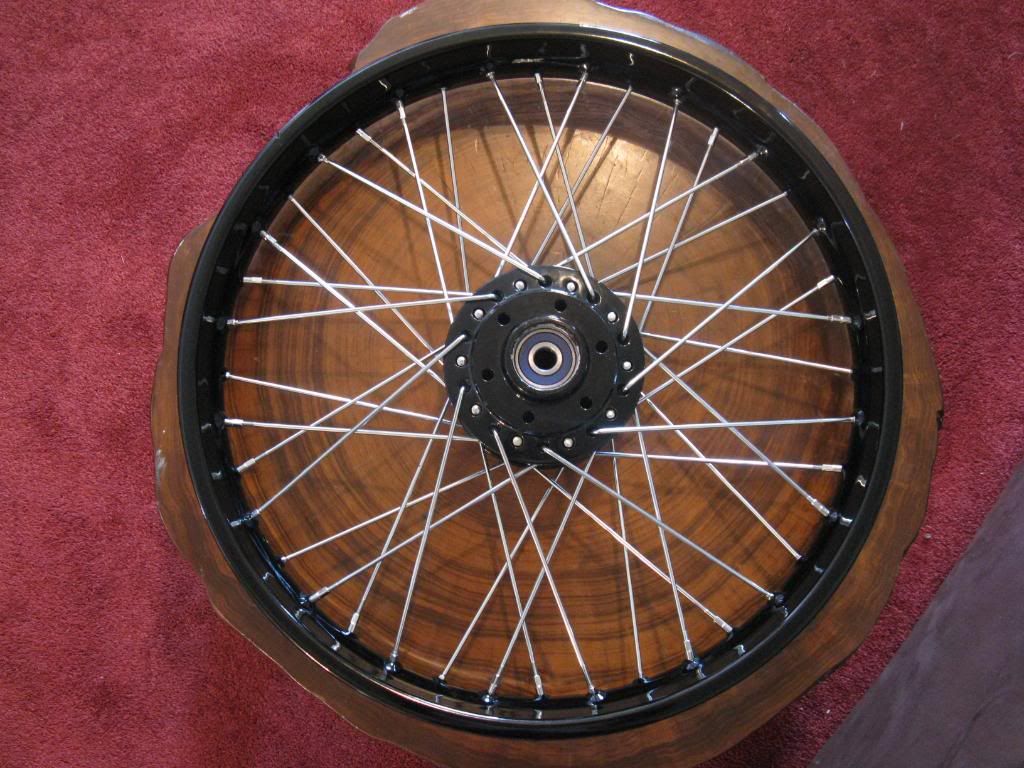

Got it worked out! It must have been one of those things where you look at it for so long you can't see it anymore!
So I looked at the pictures again and I started in the wrong hole when looking at the valve stem. It's amazing how
well it goes together when you do it correctly! :roll: Thanks for the input fellas, it got me pointed in the right direction
again. Now it's time to start truing...

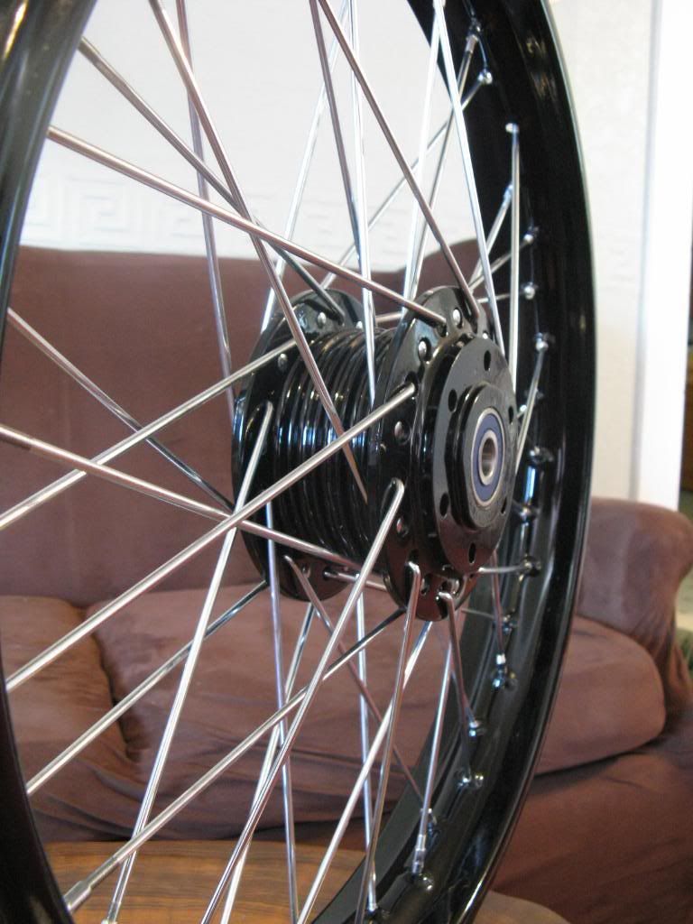

oh, finished product minus truing below...will look better in sunlight but it was 530am when I took these pics.
