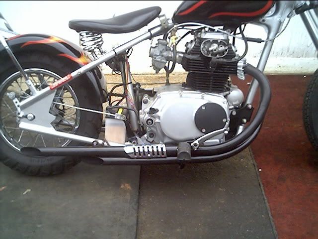

For the pipe length all I can do is show you what worked on a stockish engine for me....BUT, I was running K&N filters (not shown in pic)...

Here she is
