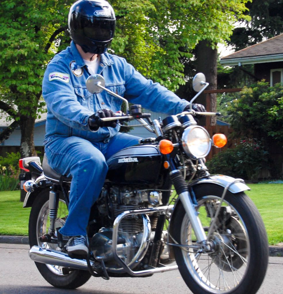

That's a great find and the bike looks nice. What did you do to the front forks?
The next time your riding past the Stark St./Burnside intersection, wave to my parents. :)
27,180 Posts

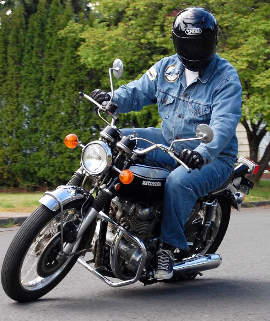

Please explain WHY the forks project different lengths above the top tree, AND, why you have them set at shorter than the " available travel length"..... (I assume one is a 750 fork/tube, but the "lowering is excessive, limits suspension cushioning, and could be dangerous.....) ?????????
61 Posts
ewww.. Good catch, guys. I think I may have missed tightening those down when I reassembled.
Off to fix the problem right now.
yikes. That was scary. Thanks for the good eyes, guys! Problem fixed.

Also, what's that large thing on the right side of the rear axle covering the axle nut?
30 Posts
the thing on the rear axle is a prophylactic... you guys need to practice safe riding

Is that just an old socket that's stuck on the rear axle nut?? If so then you might wanna get it off of there and be sure to use a cotter key to hold the nut in place..

I guess having those forks lower than they should could explain why it was so easy to drag the footpeg. :shock: I was taking it easy too!
