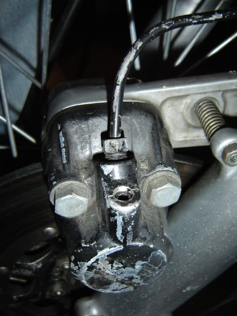

So I was getting all excited to replace the master cylinder on my CB360 when I just noticed last night that my caliper does not have a bleeder valve! Instead there is some sort of allen bolt in its place. My initial guess is my PO lost the bleeder valve (like a lot of other parts on the bike :lol: ) and popped this bolt in there to keep the brake fluid inside. So I ordered a bleeder valve from Sportland Motorsports and it gave me an excuse to also add some sidestand and centerstand springs to my order :cool:. Just a sanity check here, am I right?

You may have more problems than just replacing the bleeder. The bleeder has a tapered flange the seat on a reverse type flange on the caliper. From the picture, it looks like a countersink was done to get the bolt in there. In order to seal, they may have run a drill bit down in there so the bleeder may not work.
I'm not trying to project a lot of negative wave out there but please check it closely, that hold was not designed to have a bolt run in there.

I was thinking the same thing - once you get that bolt/set screw whatever it is out of there. Be sure to examine the taper in the bottom of the hole to make sure it isn't damaged as well. Even if the bleeder screws in ok you need to make sure it's going to seal when it bottoms.
If the caliper is damaged and money or availability are an issue it might be repairable. Let us know what you find once the bolt is removed.

took another look at the pic of your caliper
A repair sleeve may not work there just isn't that much material there to drill and tap.
You may get lucky though a new bleeder might screw right in there and be fine keep your fingers crossed

Another wrench in the works- that set screw is probably not metric, so it was probably threaded another size. Maybe not- but check the thread pitch and size on that plug. If the tapered seat at the bottom is ok, most auto parts stores carry an assortment of metric and sae bleeders in stock and you may be able to match up a suitable substitute. I've had to go that route before.

Ok so the bleeder valve and the cap came in the mail yesterday (huge package for two little baggies haha!). I think I will have some time today to work on the bike to see if the caliper is good. Correct me if I am wrong: 1. Take out the allen head bolt 2. Install bleeder valve 3. Squeeze brake a couple times and see if there is any leakage?
I am in agreement that this may be a buggered up caliper now with the fix that the P.O. did. If it were mine ( remember that I am not a very bright man ) I would just try bleeding it at the fitting. It is almost the same point as the bleeder valve. I wont be as easy but may be worth a try.
Then you could leave that bolt alone since it isnt leaking.
The only problem is that you dont know if when the brakes are really hammered on in a panic that the cross threaded bolt will stay there so the best thing is probably to replace that caliper.
Boy,,,,, I sure did a turn around on this thread didnt I ?
1,638 Posts
Alright, so I unscrewed that allen bolt and had some brake fluid come out without even touching the brake. I tried fitting in that new bleeder valve in its place, but the makeshift bolt's diameter was too large and the bleeder valve just twirled around in place. I am going to need a replacement caliper. I know Steve and Wozerd know of a spare caliper or two. PM me or something.
