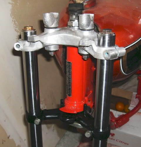

The fork tubes will be 33mm's, but are likely to be pretty rusty under the covers... Most Cafe' enthusiasts tend to swap out the 350 forks with 360 forks (much cleaner look), but this also will necessitate 350 G or 360 triple trees.... They'll bolt right on.... I can post pix of 360 forks if it will help your learning curve...... Welcome to the wonderful world of parts swapping... :lol: :lol: Steve
Nope...they are 33's as well, but the spacing and top clamp are slightly different in the way they attach.... The early 350's use a "top" or "through the tree" bolt... 350G and 360 use a "pinch" set-up... If you WANT bigger diameter, Many Cafe' bikes use the 500/4 or 550/4 front ends......
Here's a good view of a 360 fork and top tree
