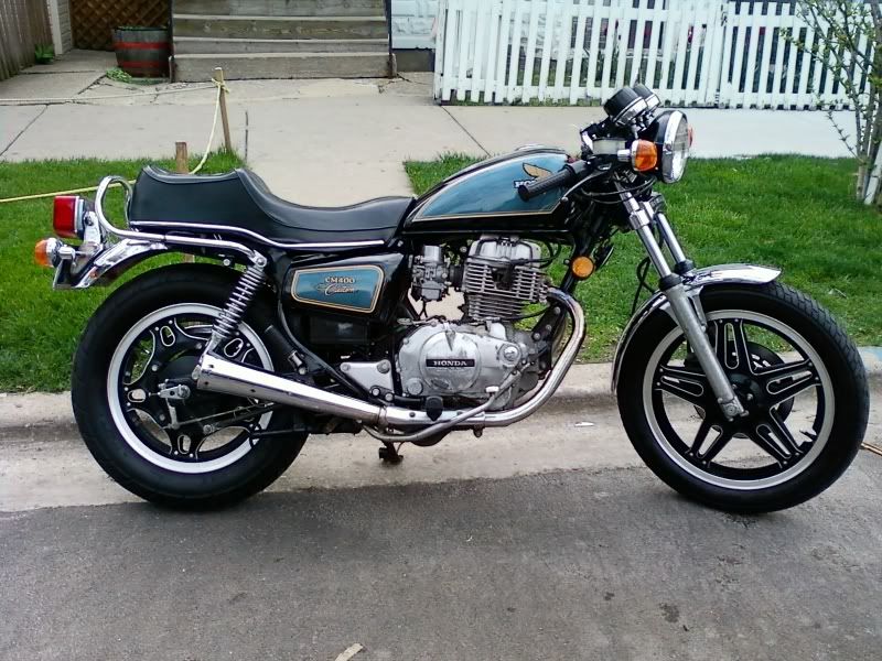

I have been told the gears on the trans are stripped and I ordered it and it should come soon; at the same time my stepdad bought a 1980 cm400t and it is doing the same thing. We have to kick the bike to neutral from 2nd. Is that the way they are supposed to be before I change the gears?
here is my stepdads bike, he bought it for $700. This is after new paint,seat and shocks.
