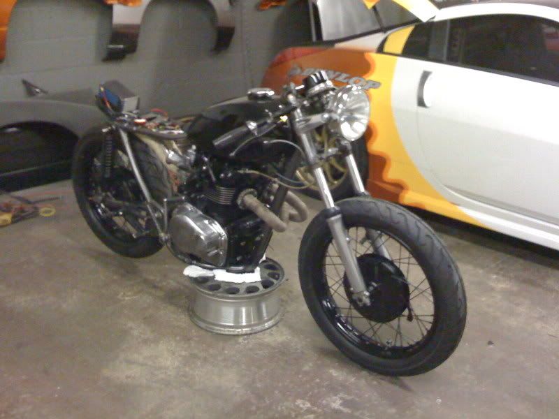

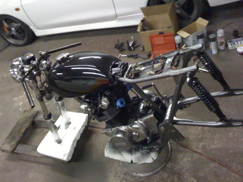

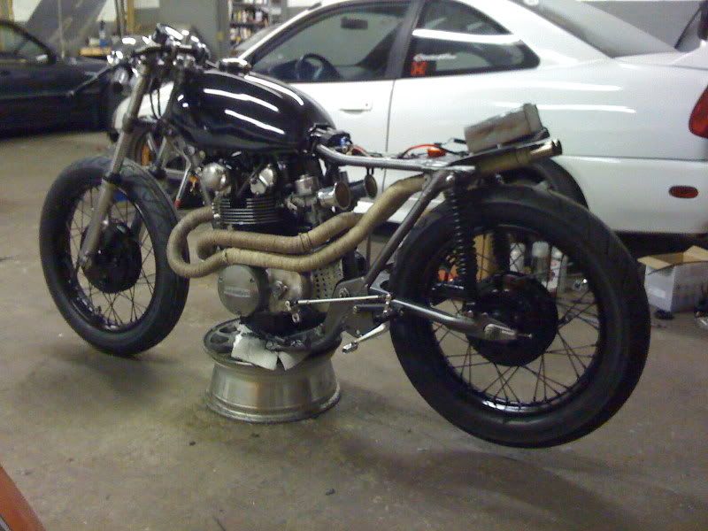

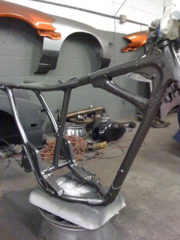

i got it 2 years ago, then last summer it looked like this
to quickly get her up and riding.....
so yeah, now that its winter im gonna redo it some, with some tricks

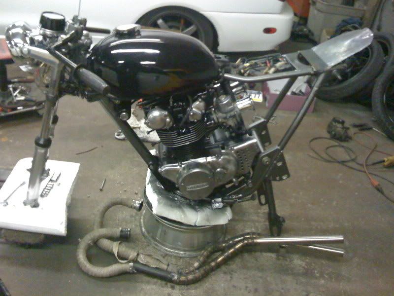

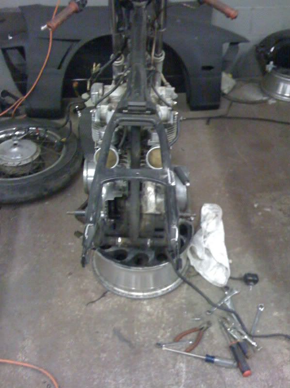

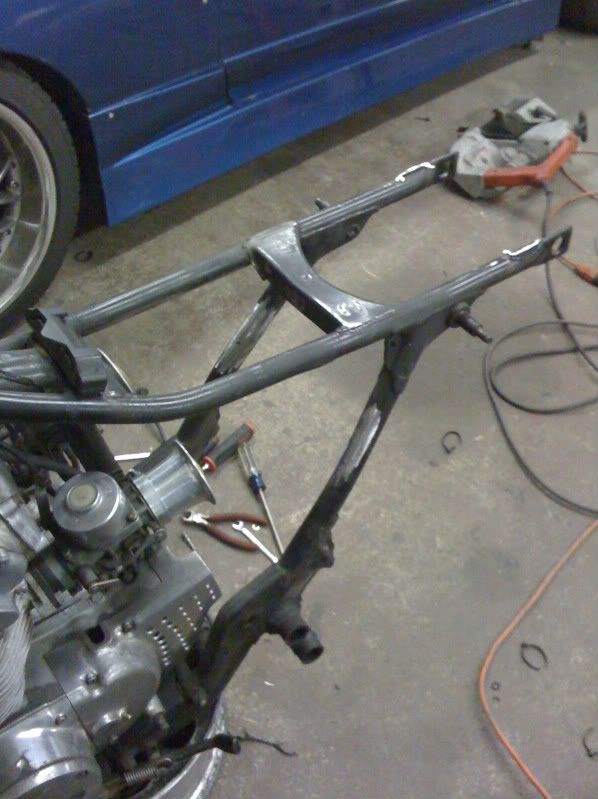

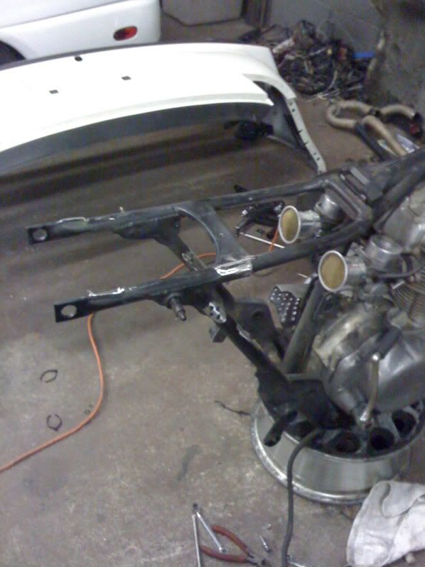

cut some **** off, smoothed some ****

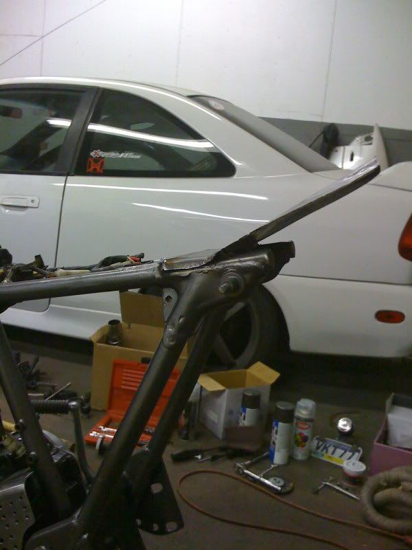

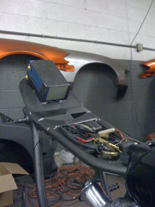

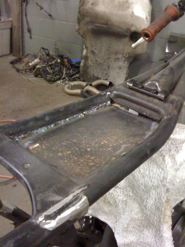

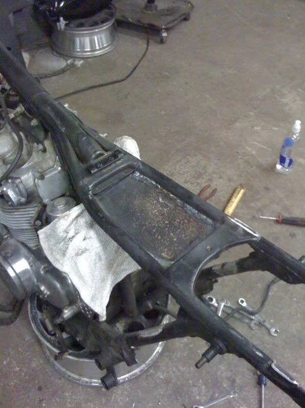

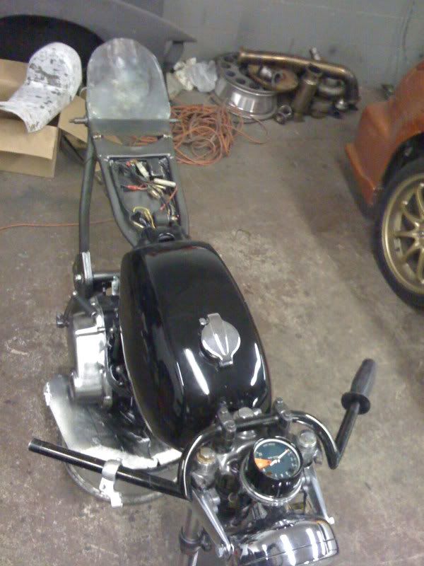

welded in the tray for electronics and whatnot

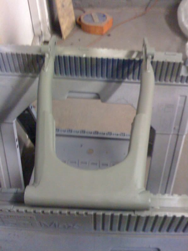

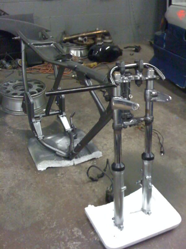

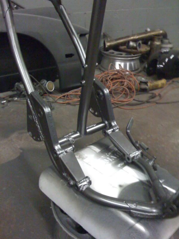

removed the swingarm....welded/filled and smoothed it then self etching metal primered it

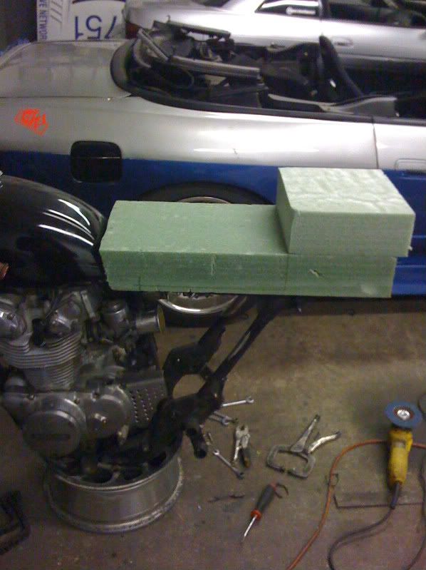

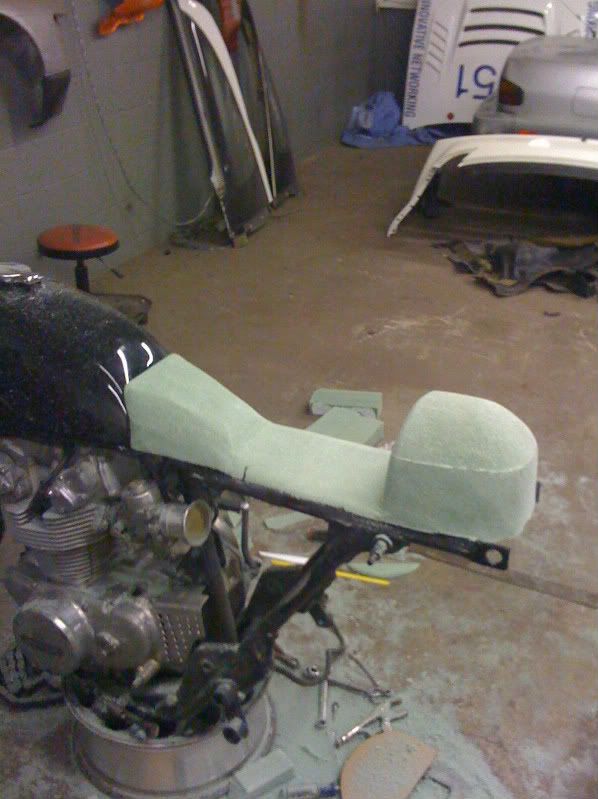

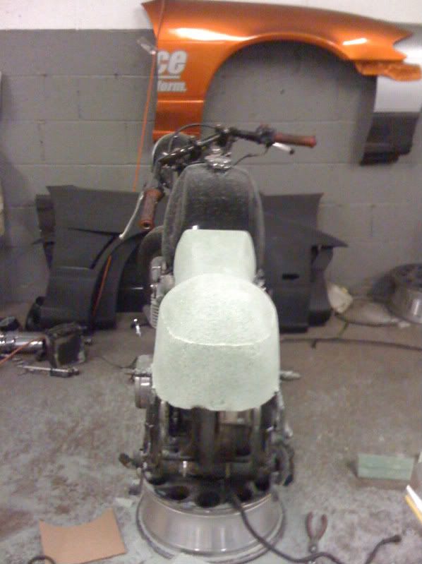

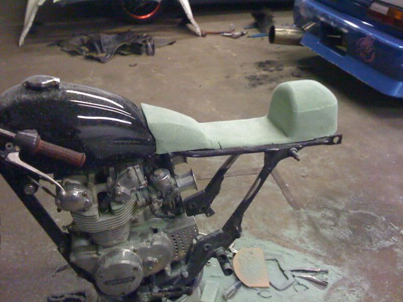

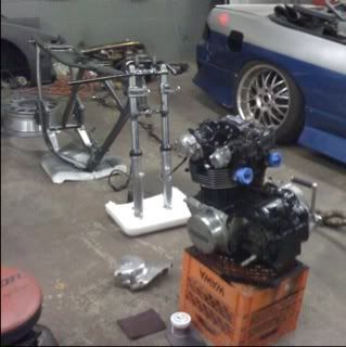

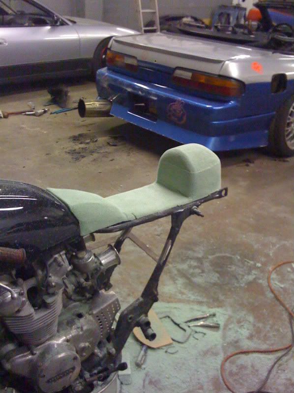

the blocks of foam looked like this when i started my seat
then they started taking shape

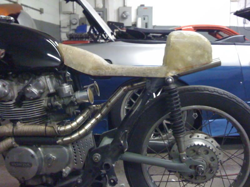

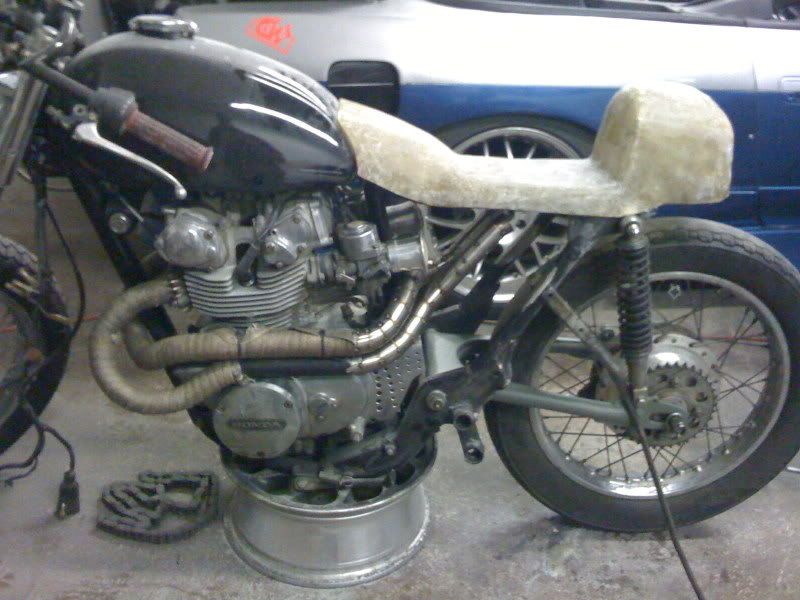

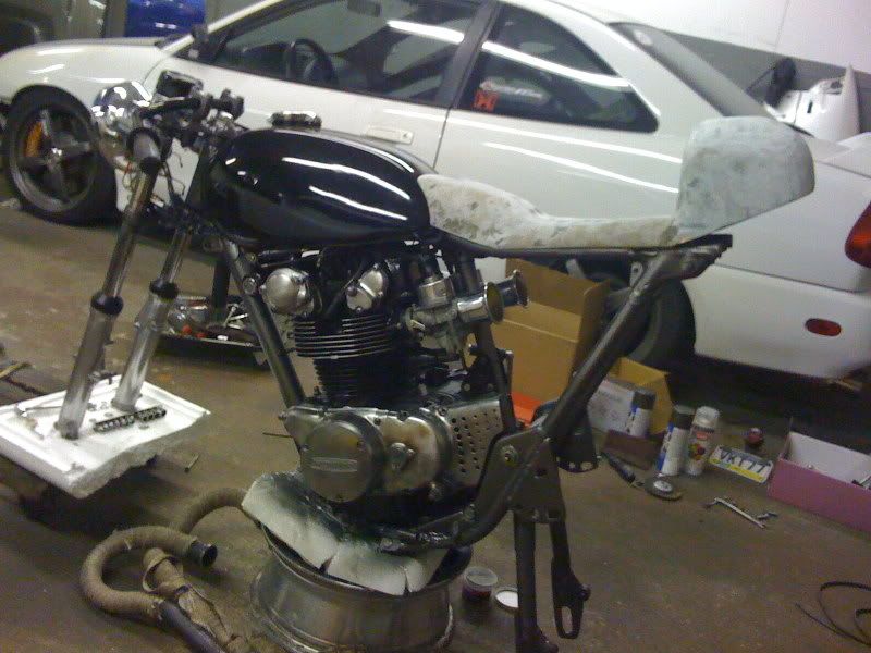

seat in fiberglass, needs alot of smoothing with bondo/resin

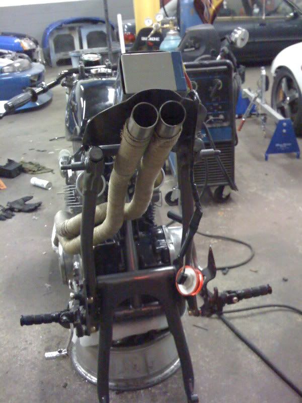

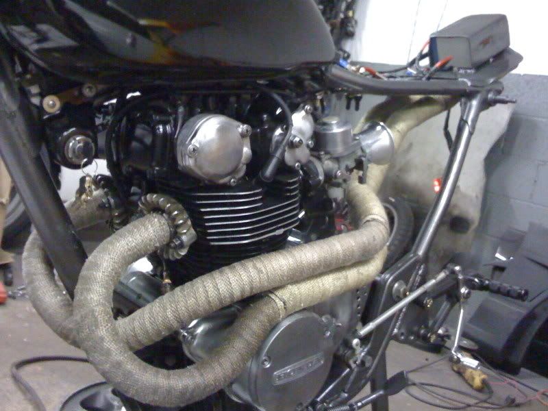

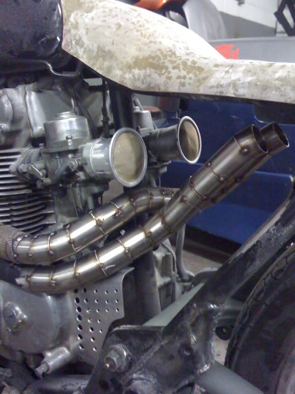

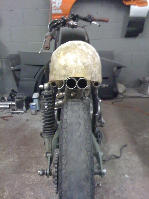

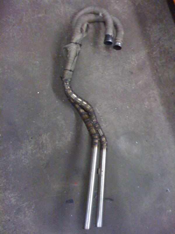

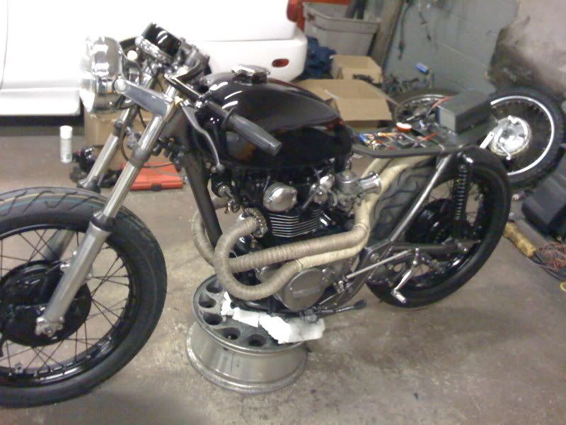

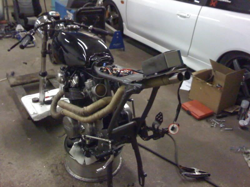

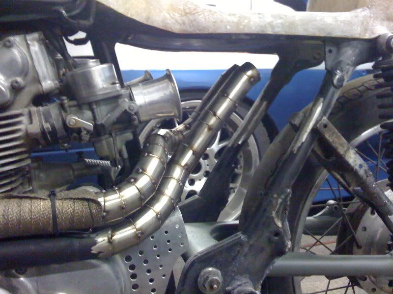

exhaust in the works (not yet done)

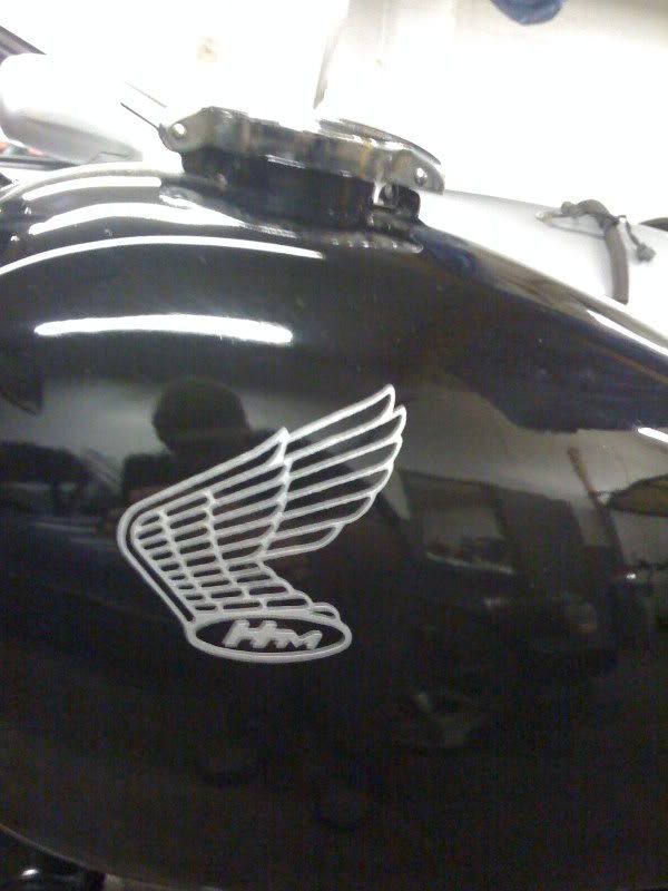

to wrap or not to wrap...that is the question
i love pie cuts

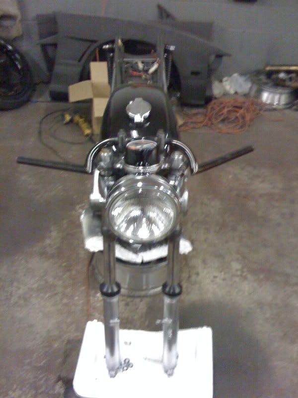

i hope you can get an idea of the color with these shots

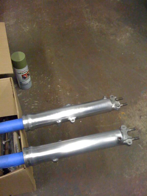

Now i need to polish those covers like i did these forks

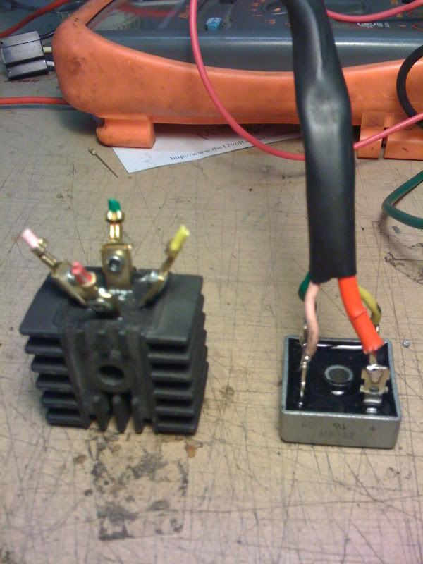

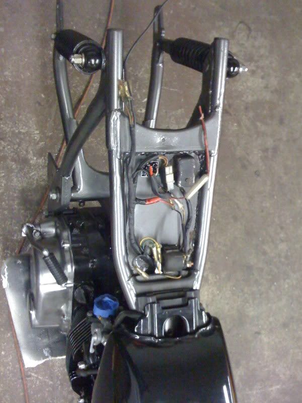

I also cleaned up my wiring harness and spruced up the rectifier

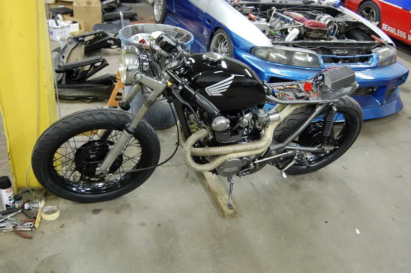

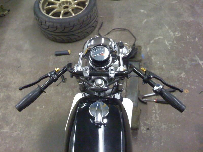

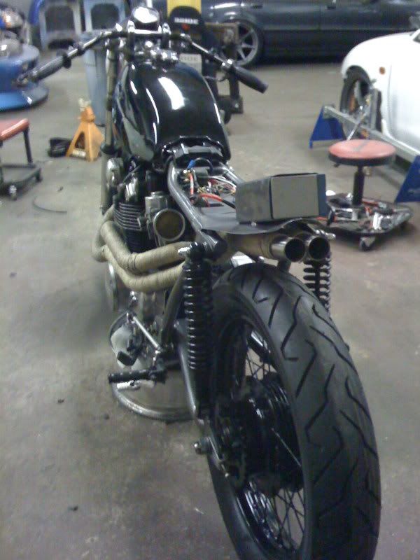

Battery box and new battery, rearsets mounted
and my new headlight switch and kill switch, soon to have water proof covers installed
looks like im gonna have tire/exhaust clearance issues, gonna need taller shocks
:eek:
and thats where she sits right now, still waiting on the seat to get sanded/painted

NE350 said:
Looks great so far. Are you gonna pad the new seat. The last one looked like a ball chrusher!
im using the same foam you would see on a vintage race bike, 1/2" closed cell foam with 3M sticky backing, the front hump is actually closer to my stomach in riding position, imagine if i had a race length tank and you get the idea.
