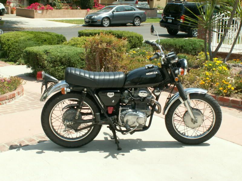

Here is my Scrambler I got for "Free" and sunk a grand into.
I look funny as hell riding this little bike but, I ride it anyways.
Your not the only tall guy to straddle a honda twin....self-depreciation is a sign of intelligence.

Welcome aboard, Ray,
Glad you found your way over here. Your bike is looking really nice. Good job. Had to laugh at the free being in quotes! Ain't that always the way... :lol:
