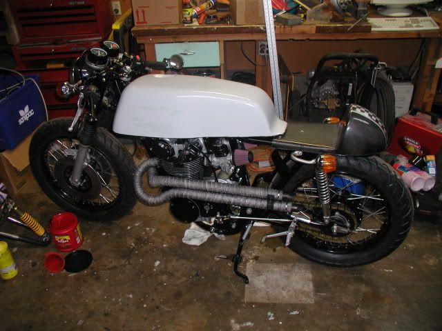

looks great! where did you find/ make/ aquire/ your body work? is it excessively loud?
101 Posts
I make the body work. We have about 5 different tanks we offer and a couple seats. Soon to have a full faring and a couple more tanks. It is pretty loud. Very much like a track bike. Loud pipes save lives though.
