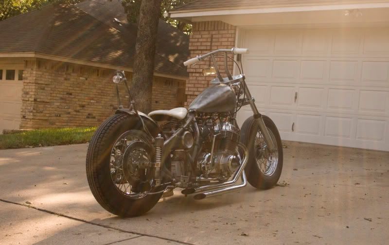

I had a cb350 that got majorly sidelined and then sold because of this project which is now essentially done and just waiting for the weather to hit its worst so I can tear it down for paint.

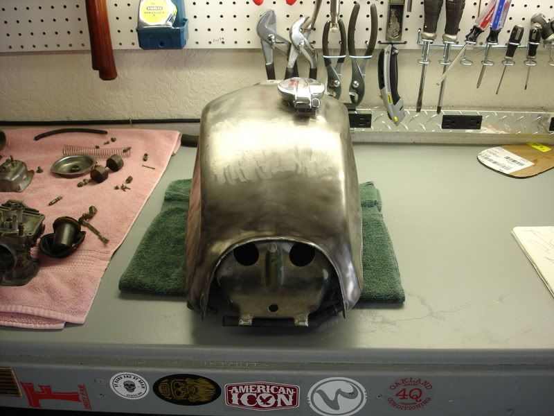

Then I started by removing all the paint on the tank and in my usual luck... it was all beat to hell. So my original plan of making some nice little knee pockets is out and I'm dishing the entire sides of the tank. For my first attempt at hammer forming I'm pretty happy with the results.

You lucky b*st*rd!! I'd kill a mofo for that frame!! Is that an Amen?? Got anyone you need knocked off??? ;) Seriously though, that's an awesome frame and the best thing is the powerplant you've got in her.. Love the fattie front tire! Excellent!
G
Almost identical to the amen but it's a Jammer frame called the "Velvet Ride". I def love it.

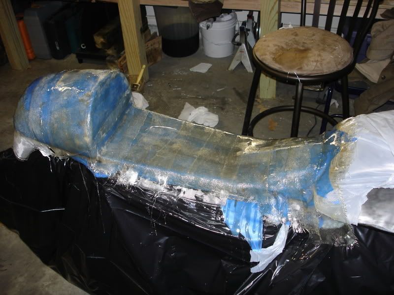

Nothing monumental. Glassed the tail section this weekend and tried polishing some parts for the first time.
Here is the tail with a few layers of fiberglass.
Now waiting to cure... I think like 6 layers of fiberglass. Maybe more layers in some areas and less in others.
Tail Section rough cut to shape. I need to smooth out some of the radius' then sand and body filler the "hump", the rest will be under vinyl so I'm not too concerned with that area.

Viewing your fibreglassing.... It appears that you don't saturate the cloth in resin before applying... The results however look pretty good despite that..... If you'll saturate them and then apply, you will get a "stretchable" layer that you can hand smooth and won't have many "dry" spots, AND, you can cover larger complex curves with less "strips" or "sections".... ( less joints, less sanding)....Just a suggestion..... Again, I like the results, especially how you flowed the seat into the tank..... And I'm jealous regarding your 750..... Steve
G
Yeah, def got the feel and figured some things out as the layers went on. I def think if I made another I could save myself some time during finishing... but I'm just going to work with this one and hopefully the next will be easier/ better.
Thanks for the tips for sure. Always welcome.
