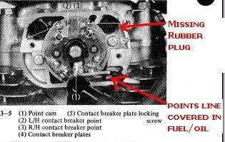

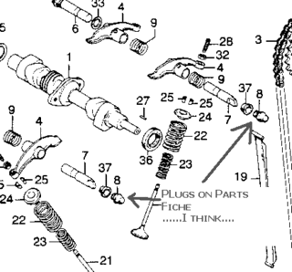

I am noticing that I have some fuel/oil on my points "line" which keeps coming back after I start the bike. This tends to accumulate on the line, the spark plug area, and 2 of the cooling fins on which the points "line" lies. I took off the points cover and noticed that it had some fuel/oil in it as well. I noticed that one of the 2 rubber plugs was missing (see picture) which is a part of the camshaft system. Is this the source of the leak?
3,893 Posts
Are you sure it's not the #36 oil seal?
That being said, I have NO KNOWLEDGE of 350/360 twins.. :roll:
My only suggestion would be clean the area really good, run it for a few minutes with a couple revs, then open it up and have a peek..
Anyone else have any idea??

Oh the thing is I wasn't sure if it was fuel or oil. Upon closer inspection it is just oil

Bonus!...That eliminates some of the "worse" possibilities...... I'd check the vent just to be sure, and replace the camshaft seal and the missing plug.....Then re-check.... Steve
1,299 Posts
on my CL350 it was seal similar to #36.
And then there's a breather hole behind it that drains high up oil to down low behind that seal that was clogged up.

The rubber plug has to be in place or oil will leak into cover. replace that first and see if leak goes away.
If engine was run without points cover in place they can fall out ('tabs' on cover hold it in place)
If the breather tube is blocked or pinched, usually all the seals will leak
In my experience, oil in that cover normally it means the cam bearings are worn enough for the cam to be pulling down on oil seal allowing it to leak (which is really bad news.)
You can remove cam cover without pulling engine though so that's a plus on 360, and, as there is no gasket you don't have to worry about replacing that. (use a VERY thin layer of silicon on mating surface)
Remove cam cover, check rockers and bearings (if its bad you'll know, or, post pictures for us to look at)
do the rubber plug first

Did your issue ever get resolved? I’m having the same issue. I have both plugs (#8) in the photo but they fit very loosely. I can see that the points cover puts pressure on them to keep them in but it doesn’t seem to be enough. My camshaft seal is good. Just getting oil from these plugs, out the breather holes, and all over my engine

Yeah the issue got resolved. Once they were replaced, the oil leak there stopped, but eventually I found out that I had a leaking head gasket, which was resolved when I rebuilt the top end. Now that I took apart (most) of the bike and restored it, I should be in even better shape!
2 Posts
Thanks Spiro, I ended up just putting a bit of Ultra Black around the edges of them. Only rode once since then, been pretty rainy in Alaska lately, but no oil showing yet. Will check again in a few days when it’s not so wet.
