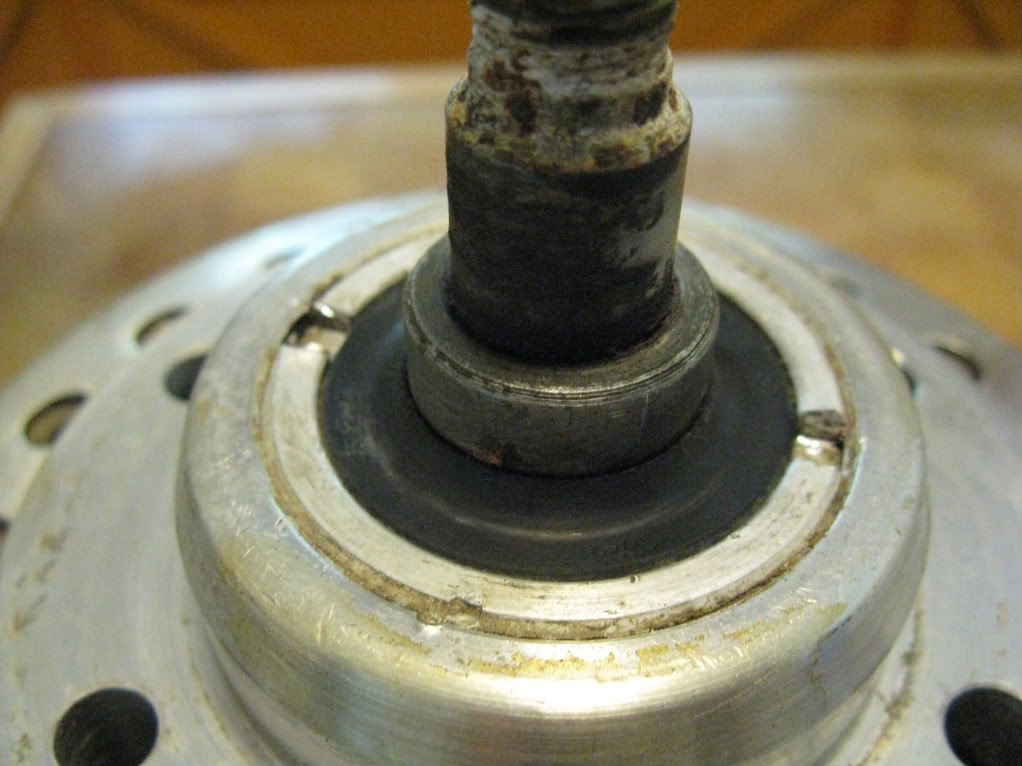

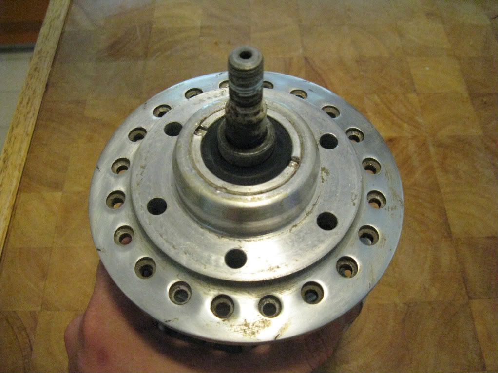

how do you get this nut off without messing it up? It looks like you need a spanner wrench or something. Am I missing something? It's off of a 1970 CB450 disc brake wheel.
sorry for the huge pics....
Remove axle, spacer, and oil seal......
Then, a bar of strap steel in vice grips will work as a wrench.....
I tap "inwards" (towards the bearing) on the bar with a small hammer while attempting to turn it with the "grips"
You may have to "remove" the staked areas by drilling just deep enough to eliminate the deformation....
