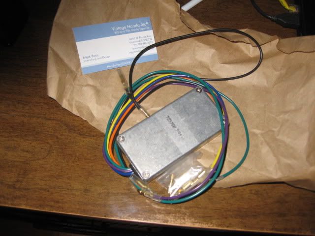

Hondaman ignition came in!!!
Now, just like the brake caliper, I need to find some free time to work on it!
Alright I wired up the ignition kit and thanks to the wiring diagram in the back it was a simple task. The bike starts up like it did before, but here is a question:
Does the timing have to be spot on before installing the kit? I am still getting some irregular pulses from the right hand side so I think I need to replace the points and set the timing back to spec...right?
