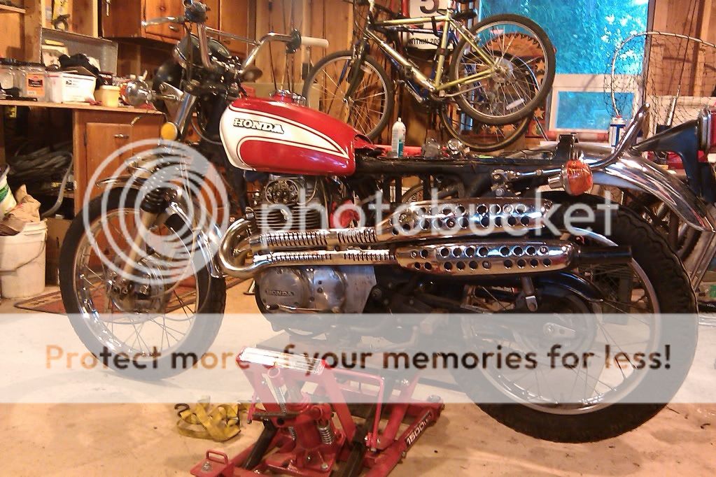

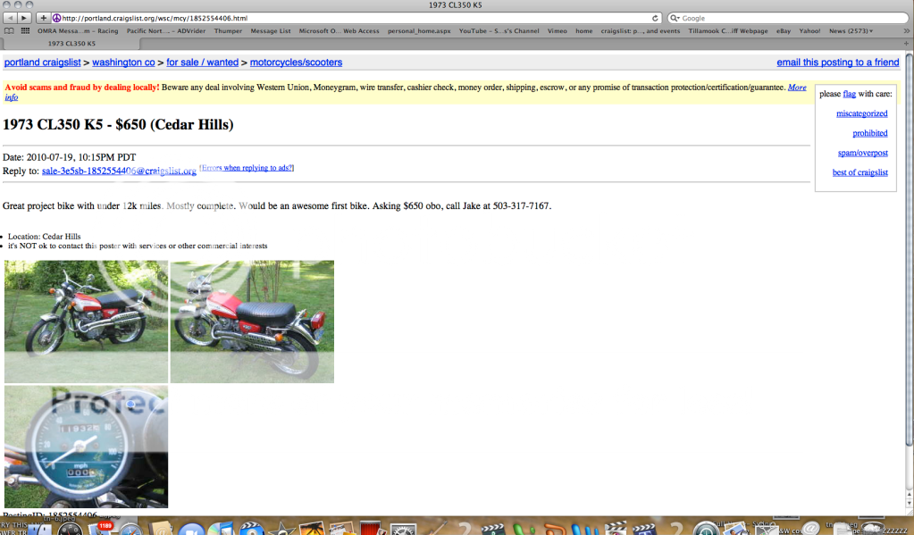

I finally found this 1973 CL350 close to Luke’s house.
The bike was not running but looked to be pretty complete. I loved the look of it and thought this would be a good starting point. It was even red like the Bergquist/Preston bike! And the price was cheap (I got it for much less than asking price). I figured that even if I didn’t use it, I could get some good spares from this bike for the race.
I got the bike home and dug in.

Holy Macintosh! This bike was way too nice for me to turn into a desert sled and race it down the Baja Pennisula. “Hogwash” said Ladybug. That’s exactly what this bike needs, she insisted. The bike had been built by her friend Larry from basket cases. It just so happens that Larry is a master Honda Technician and it showed. The bike had been in storage for more than 15 years…although it was last registered in 1999. The only thing it needed was a battery and some de-rusting of the tank. Killer Deal indeed!
Of course, I couldn’t wait for all of that…so I hooked up the plastic gas tank from my XR250 and the battery from my DRZ and gave it a shot.
After a few kicks and slight adjustment of the idle screws, she came to life!! And then she just purred like a kitten! No kidding, this thing ran nicer than my V-strom.

Let’s just say this bike is smooth as silk and runs as new. There are no drips, seeps or weird sounds anywhere! What a great place to start for my desert sled project. I will be including some modern touches to make it a little more functional like adjustable rear suspension and low-power-draw LED lights.
