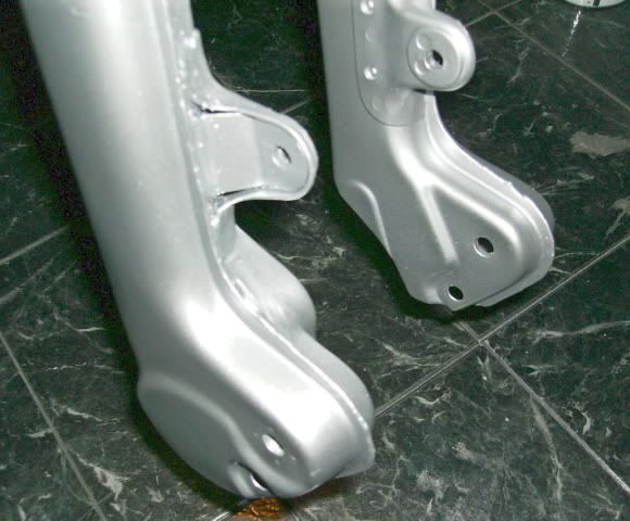

The front fender is attached directly to the hub's (2 bolts on each side) There are also 2 brake stays that connect via a strut to each fork leg. Since I have some fork damage I've been looking for a fork assembly, but only came up with a C92 NOS fork assembly. It has a couple of tabs on it for a fender attachment while the CB92 does not. Another difference is the CB92 has 2 brake stays, one on each leg, and located about an inch and a half higher on the fork to accommodate the larger diameter of the brake drum. The C92 has the single brake stay on one fork leg. I believe if necessary I'll be able to move the stays from one set of forks to the other and get the correct angle as well. At this time I don't know how much damage has been done to my forks due to bondo covering the damage. It might be salvageable as is. I know the correct forks are about $900 dollars if you're lucky:eek: Anyway these bikes have a very unique front brake, considered overkill and ahead of it's time back then. One of the extra special dealer options were air scoops for each side of the front brake as well. Mine does not have those.

As to moving (or adding) another brake stay securing tab, it isn't that difficult....I had to do so on my 90's forks to adapt the 350 wheel....(it was on the "wrong" side originally), so I simply added another scavenged from some damaged forks onto the other leg...... The mods I had to do for clearance on the DLS linkage were much more of a pain, but came out well....LOL..... More pix available if needed....:D;)
38 Posts
What are those forks too? They look different like a c110 or ca110.. they made too many variations of that bike
