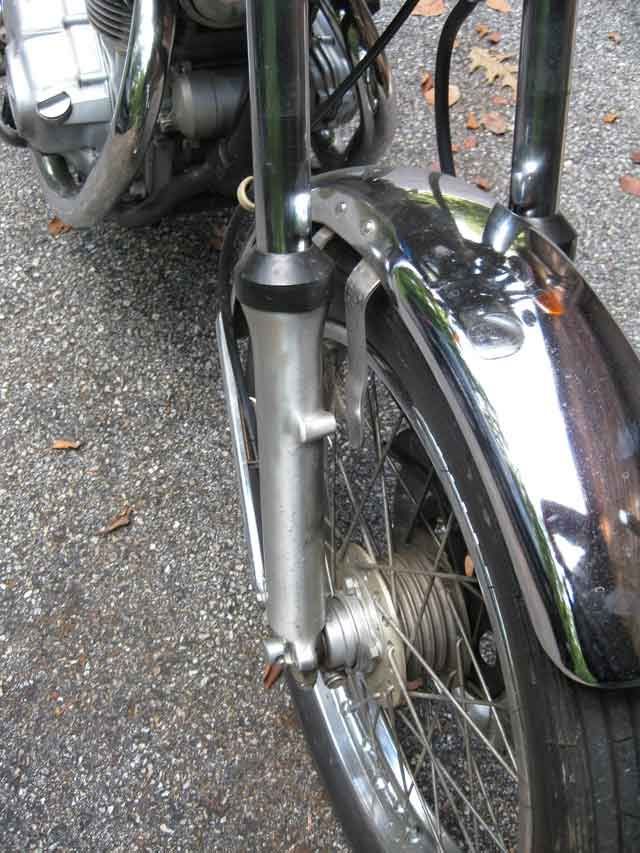

Little help? What size screws/bolts are used to secure the front fender to the left fork (looking straight on)?

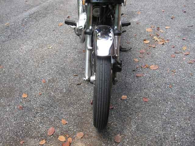

I noticed that my fender is pitched to the right (looking straight on):

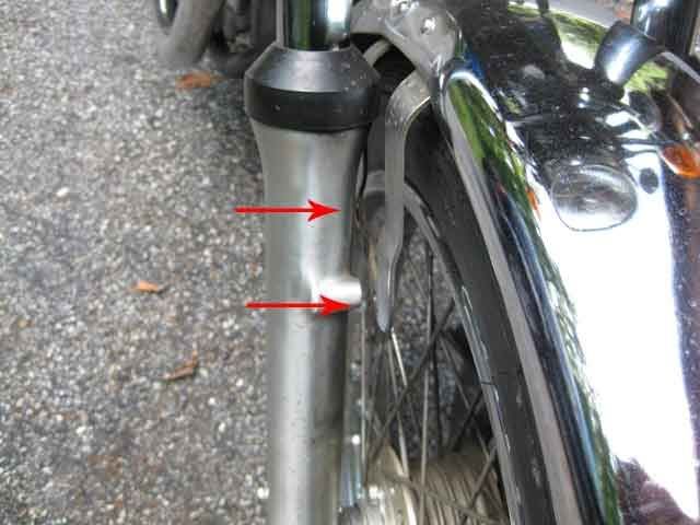

You can see that the reason is the missing screws/bolts:
These are the two that are missing:
I have no idea what size they are.
They should be regular ol' 6x1.0x14 flange bolts, get 'em at your hardware store - they even have stainless.....
You could probably use a regular (non-flange) bolt with lock washers, IF it didn't rub the tire or something.......
