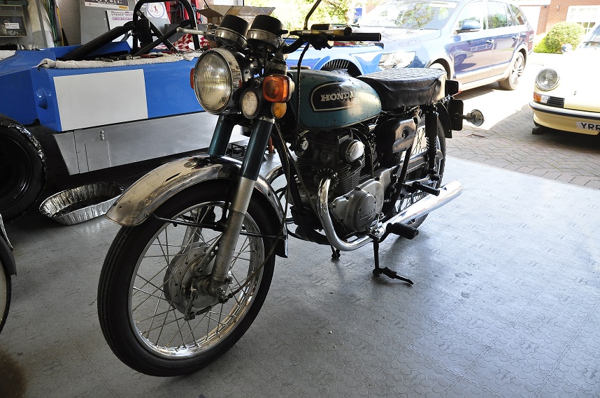

This is a resume of the progress so far on my CB175, a K6 from 1972, English spec bike.
The bike came to me off ebay, and had new DS exhausts and fresh wheels, spokes and tyres, a box of loose parts and a big hole in the base of the original tank. The previous owner had died half way through a rebuild and the whole bike was part-finished-disassembled-missing. Still. I wanted a time consuming project!
The task was simple, strip it all down and start again.
Much of the bike was loose, many bolts hand tight and much covered in a thick invulnerable black pitch paint. The engine had been 're-built' but new stock pistons were in the box of parts so confusing!
Engine out and all the bike down to the bar frame, work began about 2 months ago.in the dark depths of Lock-down due to CV19.
The engine had been apart alright but quite a mess, new pistons, no new gaskets and grinding paste still on the valves...you get the picture.
There had been a failure in the one side of the head but the cylinder block was good.
All apart, cleaned and another head and detailed cleaning and re-assembly did the trick. Oddly, the bike had a CD cam and no tacho drive (!), so CB parts sourced and the engine came together.
Box was good, clutch still on factory spec, all cases cleaned and painted. Didn't take too long at all!
So, that was the easy bit done. Added a new timing chain and found a fresh gasket set from my first CB re-build, so overall cost was quite low.
That was to change when the chassis and bodywork came on the table....
Next time!
