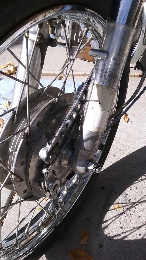

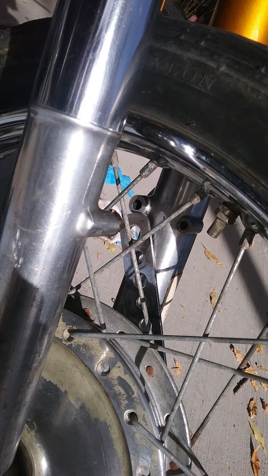

this is driving me crazy.
i took off the front fender, disconnected the brake cable... got new parts, went to place them back on.
tried to connect the arm on the brake to the forks, and:
from the other side:
apparently in a few minutes, the rod shrank?
anyone know whats going on here?
3,176 Posts
Rotate your brake backing plate backwards a little. You probably moved it a bit without knowing it.
37 Posts
indeed, it ended up being a geometry problem.
had to loosen some other bolts, but got it back in.
sheesh!
