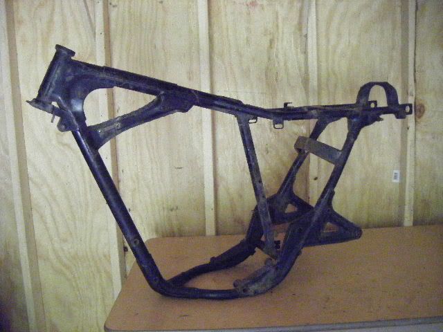

From this....
to this........
As you can see, I'm just getting started on this. Looked for a project for years before stumbling on this at yard sale. Good title, $100. Plan is to rebuild into sort of a cafe/bobber. Long term project, I'm in no hurry. Got an HD dresser for everyday riding. Next step is to start shaving the frame of all those tabs and brackets I won't be using. Already ordered bronze swingarm bushings. Plan on tapered rollers in the neck. Already pulled all the bearing races. Clubman bars. 4.00x18s front and rear. Feel free to post any tip, tricks, part #s, suggestions. Looking for a suggestion on rear shocks, mine are rusty. Would also like to go a little shorter.
