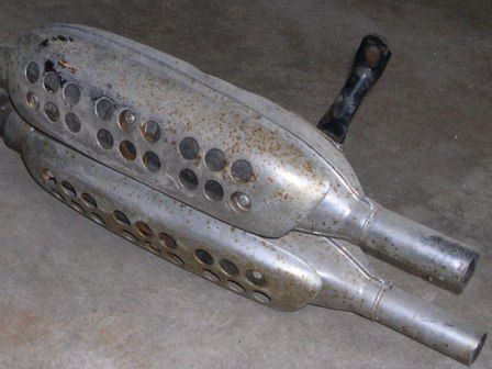

Here are some pictures of the exhaust shields on my CL350. These are the same parts in both pictures. I removed the rust with chrome polish, soft cloths, and lots of elbow grease, and they look acceptable as long as you don't get too close. The pits are still there, but the surface rust is gone. I believe oxalic acid would have been a much easier way to accomplish the same thing. I wasn't aware of it at the time. I will be trying it on my next project.
