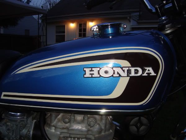

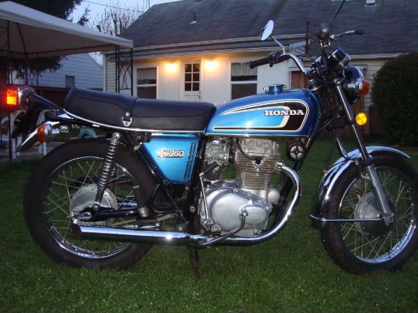

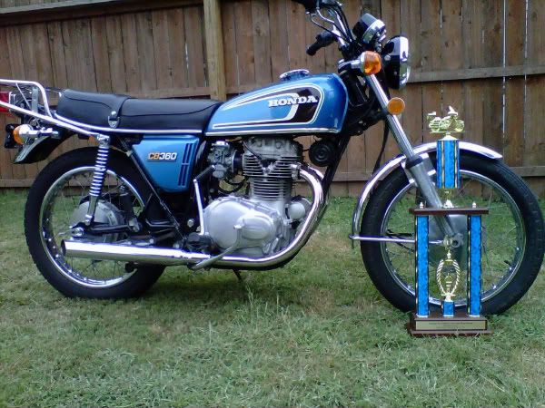

I figured I would start a build thread for my '74 CB360. As always I will provide pictures with my progress, because pictures are the best part, right? I have code named my project CB360-A :ugeek: My plans are take this wonder Honda and add a twist of my personal style while maintaining the "classic/vintage look" of the CB360. I hope you enjoy the progress, and please feel free to give comments, as any input is better than none. And so it begins..............
The First day she came home :D

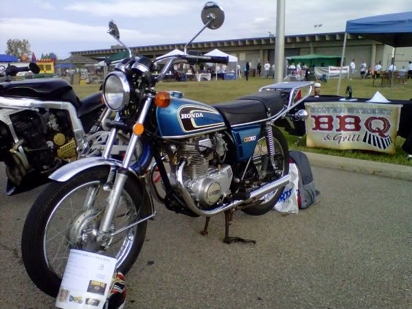

The classic car & motorcycle show
The the luggage rack

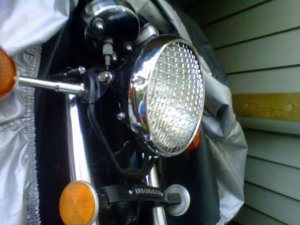

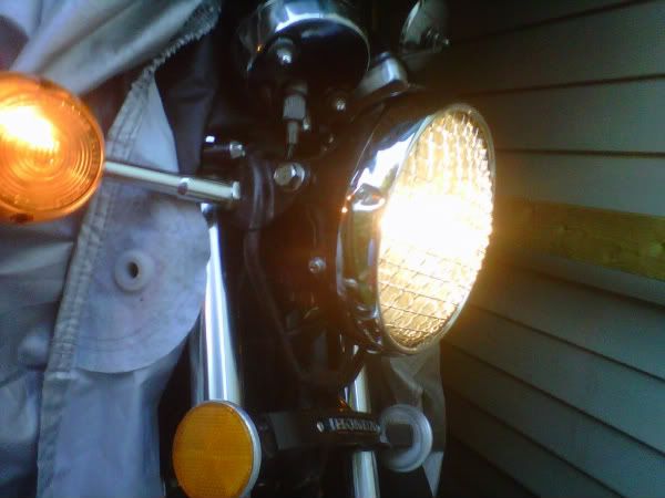

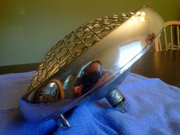

The most recent addition, a headlight stone guard :D
