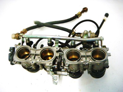

I got a set of 4 throttle bodies, injectors, fuel rail, throttle position sensor and whatnot off of ebay from an '04 CBR600 F4i. The injectors should be fine size-wise, since the cyl size for the CBR is slightly smaller, but it rev's a bit higher. Original pic:
One of the castings is a little bit broken, but overall they're in great shape, especially for $43 w/shipping. I've since chopped down and re-welded the fuel rail so that it'll only span the one bank that I'm planning on using, drilled and tapped some holes that I'll used for a solenoid to control the idle valves and to mount one end of the fuel rail, and in general prep'ed the new throttle bodies for use on the bike. In their completed form:

Well, pulled the seat, tank, air filters and carbs off of the bike today, and came to the conclusion that theres no way in hell I'm going to get the throttle bodies in the position I want them in without cutting them apart. The inlet ports in the head are just spaced too far apart, and there's not enough clearance between them and a frame member to get the throttle bodies installed in a way that'll actually flow fairly well.
Looks like I'll have to cut them apart after all, extend the fuel rail and throttle butterfly shaft, and possibly the idle actuator too. At this point I may just ignore the stock idle valve in the throttle bodies and instead just run a complete solenoid valve with a restrictor to simplify packaging.

In other news, the throttle bodies are just about finished, with only a little grinding left to do to get them usable. They fit on the bike, and the fuel injectors are lined up pretty well with the valves. There's enough flexibility in the mounts that I'll probably need to make a bracket that will attach to the frame at the battery tray mounting bolts, but the throttle cable works well. I'll be able to route a rubber hose between the two fuel rails since the feed is on one side and the fuel pressure regulator/return is on the other. As for air filters, I should just be able to take a tube, mill a ring in it to seat an o-ring, and hold it in place with a couple bits of metal to the stock airbox mounting bolts on the throttle bodies, and then mount an appropriately sized filter over the end of that.
