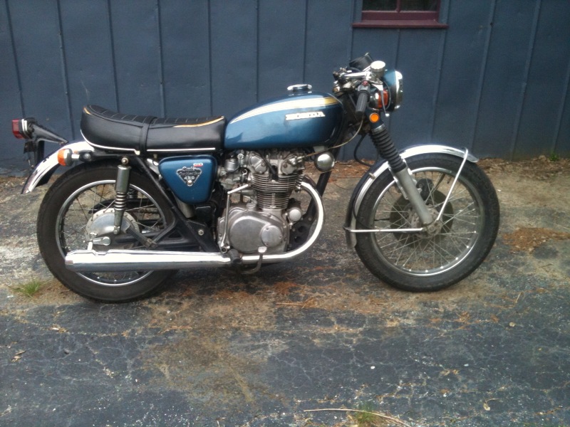

Just picked up this CB450 for a very reasonable price. The bike has all original paint, only a few blemishes, decent shape over all. The starter clutch and chain are in a separate, so obviously that needs to go back in. I have several big projects going on (a 72 Bonneville and a 71 BSA Thunderbolt) but i needed something to ride. I love the early 70's CB's. Modern convenience of electric start, classic lines, and great handling. Anyway, I want to clean this up, fix all the leaks, pull some dents etc... here are some pictures so far:

Great looking bike, it will make a nice project. However, it sure does look a lot like what I started with. :0
13 Posts
Mike, wow, thats identical with the clubmans. Hey where did you get that low profile mirror? I like that?

The mirrors just look low profile in that picture. They are regular mirrors.
GB pointed me to a guy on eBay who sells a side panel screw made out of polished stainless steel. He also has the rubber parts. I ordered a set last week and hope to see them this week. They are not cheap but at least they are available. If you are just looking for one screw and don't care about condition, I can send you one of the ones I'm replacing when the new ones get here.
