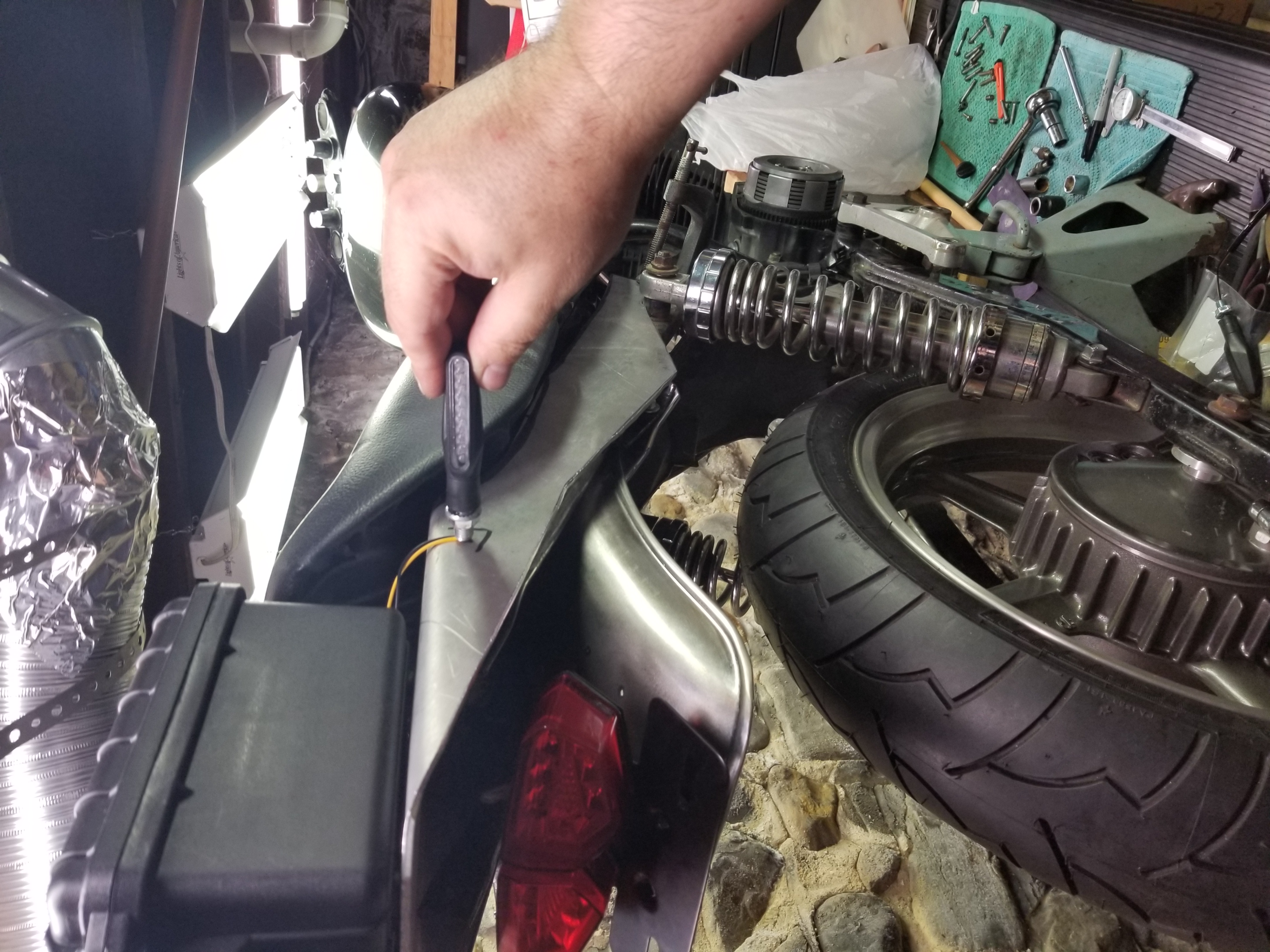

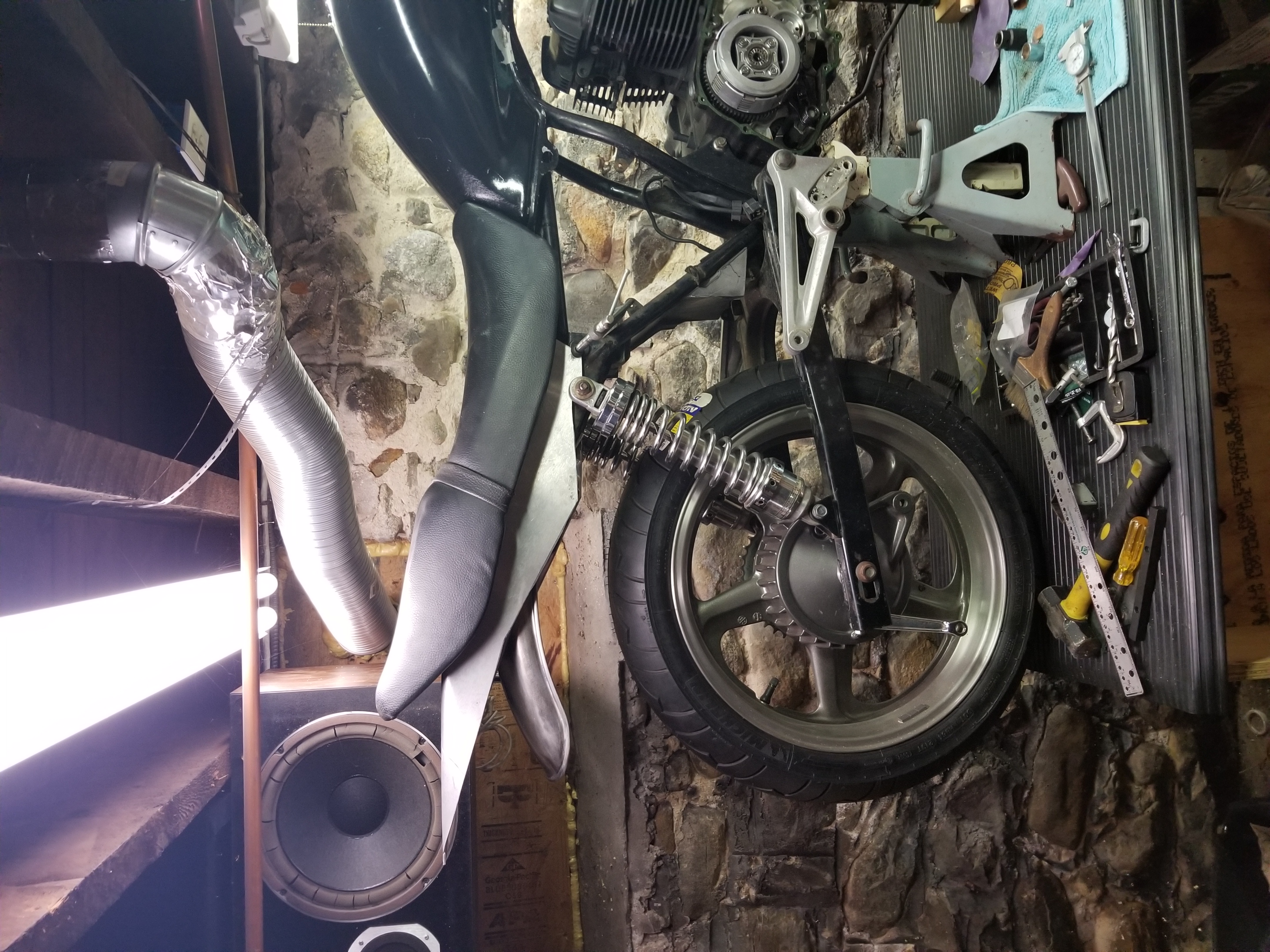

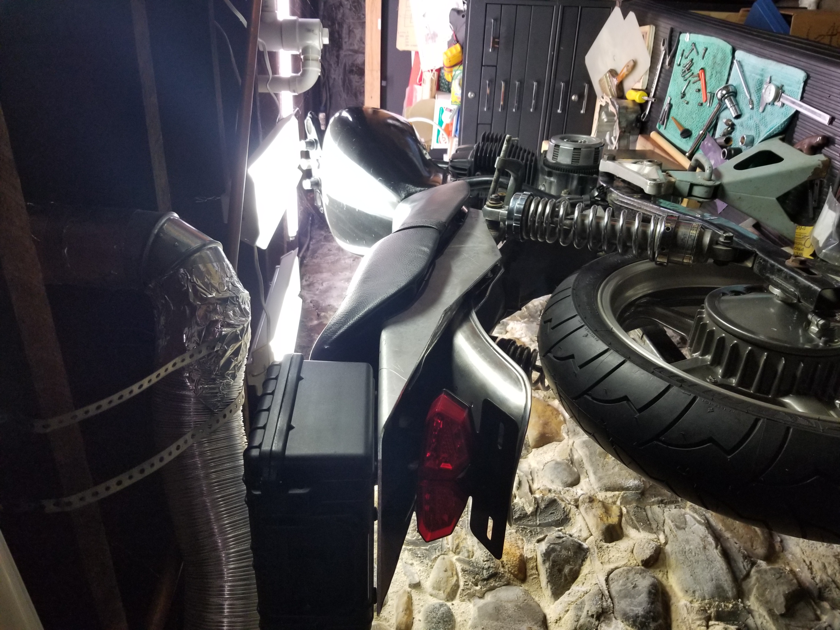

I spent some time on the bodywork this afternoon, it still needs more attention but this will be the final look. I'm thinking of painting the rear fender black appliance epoxy with the frame, but the aluminum rear bodywork I'm thinking of polishing.
Thoughts?
When I first made the bends and a few first cuts I'd left it big, clunky and ugly like this:
Today I made some more cuts and with the exception of some finish work on the edges it'll stay this way:
And I'll probably add turn signals here:
