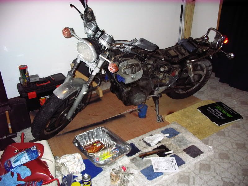

A little late getting pictures up since we brought it home a week ago but here they are anyway. Background, as the title says its a '79 CM400T with 15,000 and change miles on it. This is going to be a project for wi5ea55k (my girlfriend's advrider screen name) and myself. She's always wanted to restore an old car, and then lately mentioned she wanted to learn to ride a bike. So here we are with an old bike to fix up, and it will be hers to ride when it's finished.
So far we know we need a gasket set as there is a pretty bad oil leak, the tires are weather checked, seat cover is shot, and I'm assuming I'll have to rebuild the carbs as it has been sitting since for a while considering the inspection sticker is dated June of 07.

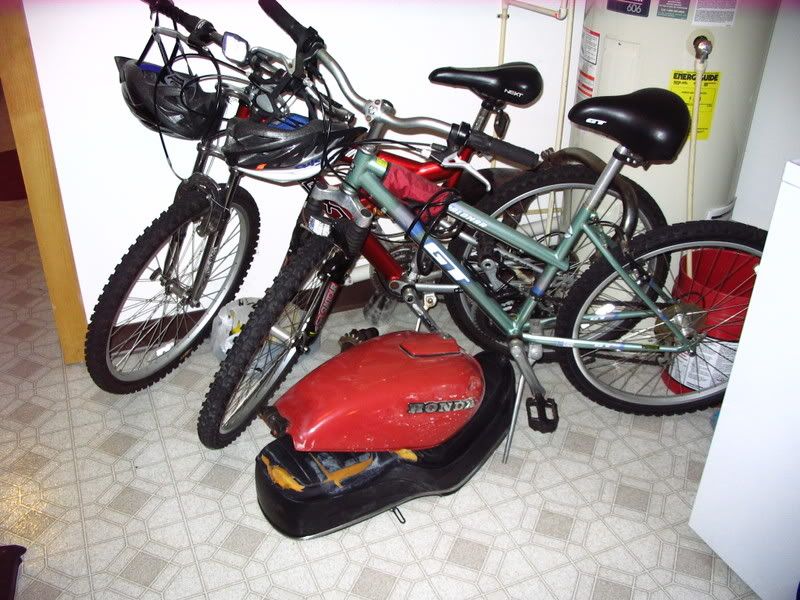

Being that we have an apartment with no garage, the laundry room is our makeshift garage, fun stuff.
The exhaust system is hiding by the water heater. Was fun trying to get that off as one piece since the gaskets are all hardened and I've yet been unable to get the cans and one header out of the collector.
