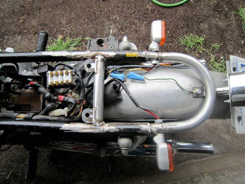

This is my first bike, I bought i few months ago and found out 500T parts are pretty hard to come by. I took apart the carbs and replaced the air cut valve on one side. They don't make anymore for the 500T but a good replacement came from a GL1000. I just cut down the brass pin to match the stock valve. Other than that I put on some superbike bars, K&N Filters, put a return hoop on the back and cut off all the old seat brackets to make way for a lower profile seat, the rear fender came from 7 metal west. Next on the agenda is a lot of riding, then a Copper riveted battery box, 2-1 one exhaust, new firestone champions on black rims, smaller front fender, maybe some smaller gauges. Polish and clean some bits.
41 Posts
got the seat done, 71 triumph 650 drum fitted, New avons. Waiting on shorty mufflers , new gas grip and wheel bearings for the front. got rid of the right hand controls and I am going to try and build a little box to house a turn signal switch. and get rid of the bulky left hand controls. I wired the head light to work off a toggle switch on the headlight bucket too.
