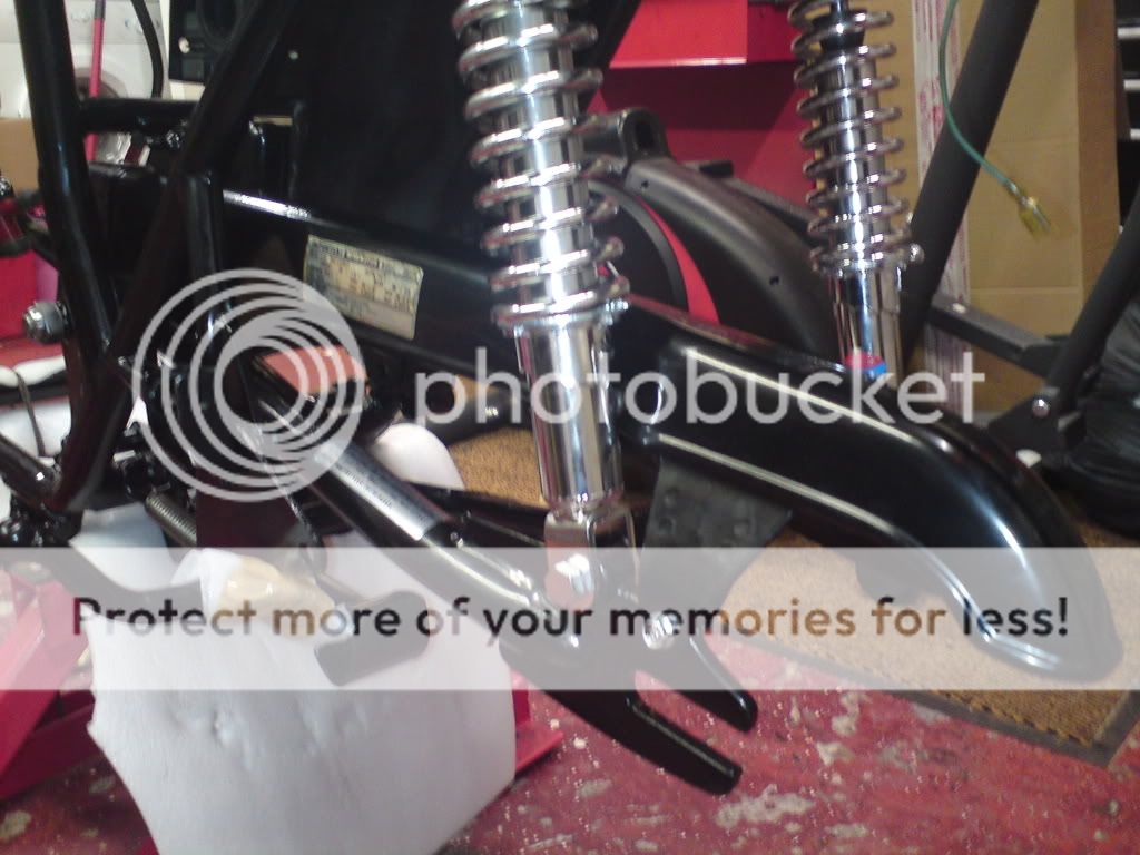

The swingarm was next up after having new bushes fitted and liberally greased, it went on a treat allowing me to bolt in the rear shocks.....
..... and fit up the chain-guard with its salvaged tyre info decal. As you cant buy them from Honda anymore, i thought this would add a bit or originality even though i probably could have got one made.

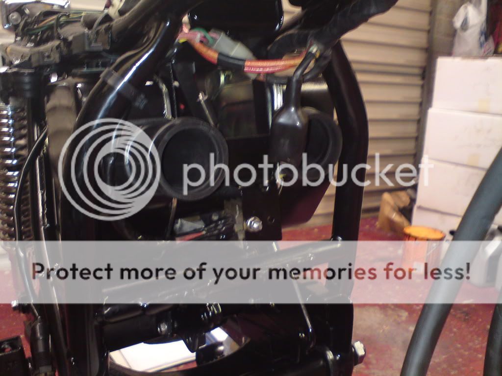

Brand new air filters were then fitted with their freshly blasted and painted (by me) cases.
