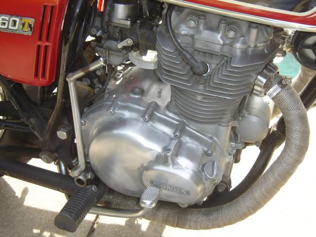

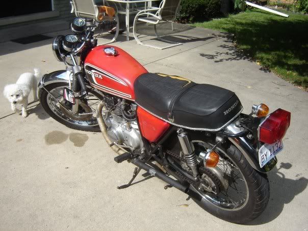

So here is the bike that I am working on. I purchased it from a private seller in Gurnee IL. Aparently the person that owned it rode for ~4,000 in 1975-1976 and left it in storage till recently, and began restoring it. He ran out of funds and sold it to the guy I bought it from. He rebuilt the engine, swapped the rear suspension and forks with a CB400 and salvaged carbs from a parts CB450 bike. He replaced the bars with clubmans, took off front turn signals, and mirrors, and left a cafe style mirror on the left. He also replaced the stock exhaust with some of his own making (I love the thermal wrapped headers!).

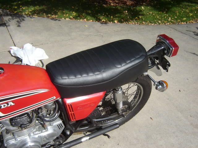

Future/Current plans: I am restoring the engine case and heat transfer fins to their former shine with a lot of elbow grease. The seat has been replaced with a Saddlemen replacement cover. I need to buy an exhaust clamp for the pipes since they were bolted together with 2 screws (very wobbly). I am also looking to replace the brakelight with something cooler, and then just repaint the tank and side covers to a wine red color.
Here is the bike when I initially got it:
Here is the new replacement seat cover:

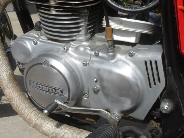

Here is the polishing job thus far:

Excellent start.....just keep it up!....
What's up with the pipe cap?.... Leaky carbs?
Steve
Steve
I thought it was leaky carbs, it turned out to be a fuel petcock that shuts off only when you hit its "sweet spot"
That is a common problem..... Sometimes a thorough cleaning will remedy it, sometimes a "new" petcock is required (about $50).......... Just thought I'd warn ya!..... Steve
Yeah I was eyeing one, but I am going to lump that order with a bunch of other parts to save on shipping. At the moment, I set the switch to about a millimeter below "OFF" and it work just fine. Anything else, and I get a couple tablespoons of fuel in said PVC cap the next day.

Update: I took off the stator/generator cover and from 7pm-9pm I just wet sanded the crap out of it. I finished up with some steel wool (very fine) and Mothers Mag/Aluminum polish and it is SUPER shiny and reflective, almost a mirror finish! Too bad the rest of the engine is quite the opposite :lol:
I tried prying away the left crankcase cover, but even with liquid wrench, the screws wouldn't budge and the heads started to wear away, YIKES!
(yeah yeah I know,...pics or it didn't happen, hopefully I can get a comparo pic once I reclaim my digicam)
An impact driver is the tool you need..... If you don't have one, an easy method (but it destroys the phillips screws ) is to hit a 8 or 10 mm bolt into the top of the screw (fairly hard, usually several blows, and until the + flattens a bit)....Then Hit (drive) a #3 phillips driver in to open the + back-up and apply hard twisting pressure.... most will "pop" and come right out.....
If anyone here EVER plans on working on anymore old Honda's then they should own an impact driver. It'll save you a lot of headaches. Plus they're cheap if you shop around. Get extra bits for it as well. You're gonna snap a few.
