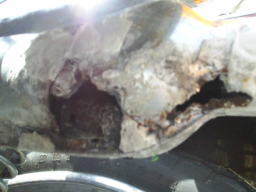

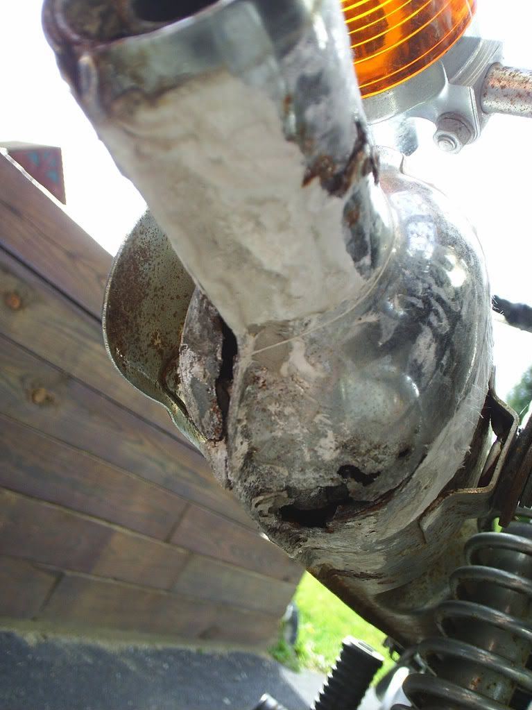

I have cleaned the right carb, still have to do the left, it appears I have to remove the exhaust to get the air filter cover and filter off. The right filter seems to have been the host to a rodent at some time. I am waiting for a condenser to arrive, then hopefully I will be able to start it, the fuel tap seems clear with good flow through it. The main problem I have is the muffler which has rotted through, pics below, has anyone ever tried cutting out the damaged section welding in a patch and had it rechromed?
If you get a "perfect" weld, the repair will still show, and it will cost LARGE to re-chrome, as it will be a large square inch piece.... I think it costs about $150 (each)just for a short CB headpipe, and yours are much "bigger", especially the header with the muffler welded on..... That $400+ or so probably would buy a NOS exhaust if you can find it....JMHO... I'd saw it off and run Volkswagen "tips".....Steve

thanks for that otr002 the first is off the sloper engine version so will not fit but the second one looks the part.
thanks again 66sprint but I would prefer the standard look.
I sort of knew you would... Just didn't want you spending all that $ on a re-chromed repaired one when decent used or NOS are available.... ;)

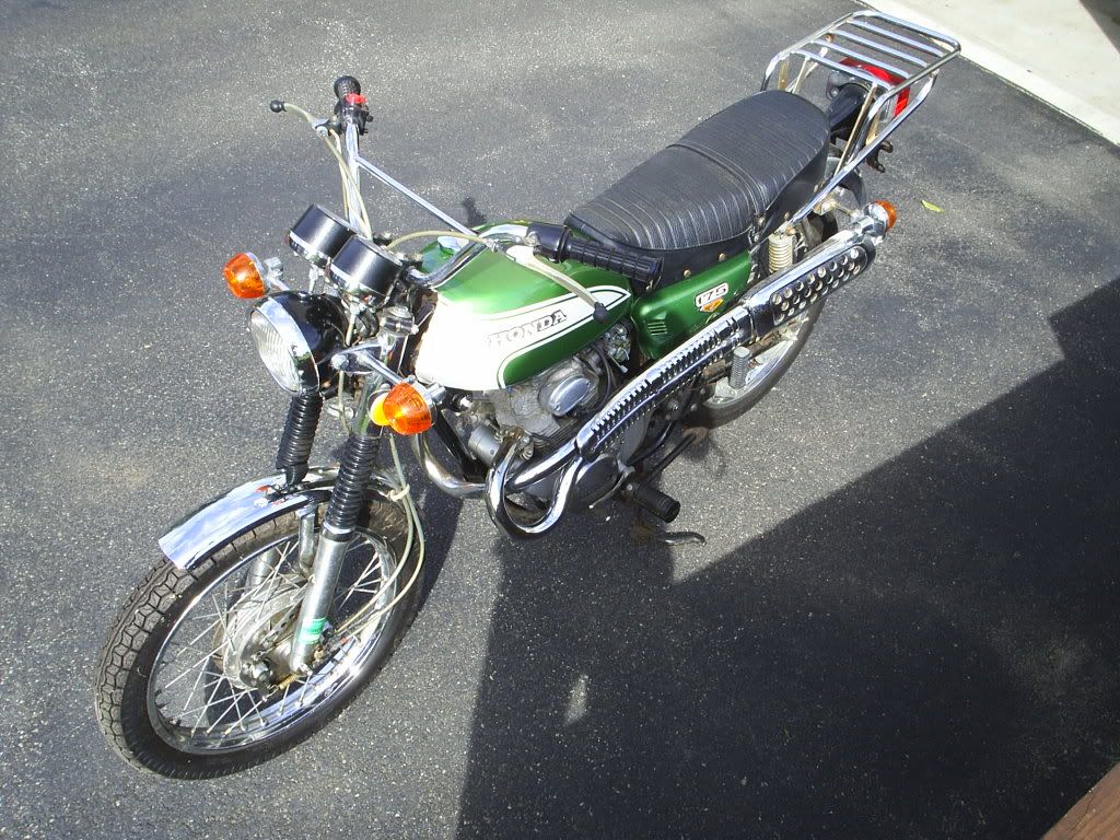

It also has a rear rack on which I would like to take off, but looking at it I think the brackets for the indicator stalks are missing, can someone confirm and tell me what is missing and again if anyone has the parts to sell.
While on this point the rear seat hoop fitted to 1973 model has been removed possibly to fit the rack, if anyone has one I would like to buy, the rack will probably be sold then.
Malcolm, I have a spare choke linkage half for you.....I'll need a "shipping" address, e-mail your info to me as [email protected] ......
All of my (K6 and earlier) Vertical 175's use the bolt-on rear frame brace/seat bracket as the mount for the signals.... Yours looks to be the welded-on version, so I assume you are correct about the mounts being integral with the seat rail like the bigger twins..... I never had a K7.....

Ok looking at that maybe the indicators fit on the rear grab rail which was probably removed to fit the rack. Steve I understand now about the bolt on/welded rear hoop, learning a lot here thanks to you both.

Another problem has come to light, I cannot get the exhaust gasket which goes between the left front pipe and the right pipe/muffler, the two pipe diameters are about 1/4" different, any idea what I can use to pack out and seal the gap? some sort of fire proof webbing I would think.

Spoke to a local Harley motorcycle shop http://www.blacksmithcycles.com/ he recommended some header wrap for my exhaust problem, even gave me a small piece and said when he did a similar job recently he put a smear of hi temp silicon seal on, so will now replace the exhaust hopefully before I leave on Saturday.
