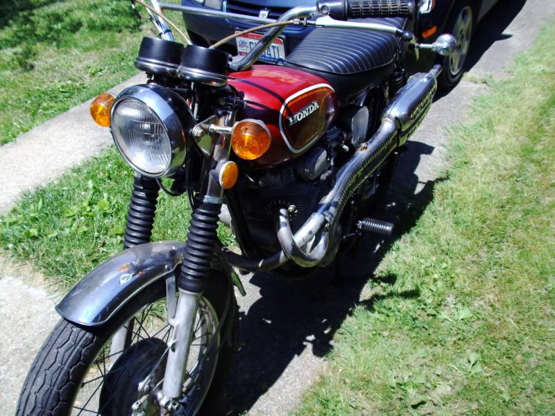

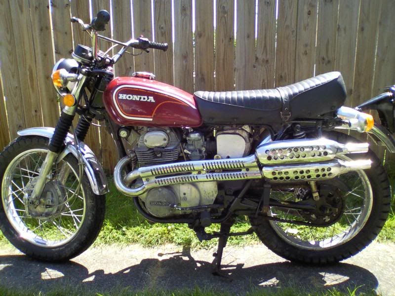

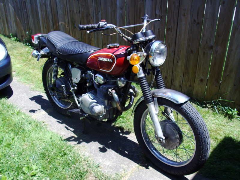

The thing was runny pretty well when I first got it home, took it on a 30-40min ride and it kinda whent to sh#@. It would not idol at less than 2 grand on the tach, and would hardly move at all untill I got it up to around 6 grand on the tach. No real power though any of it. Which is why I believe it a fuel issue. Checked the petcock, it leaks in the off position so I have to fix that. I also took off the right side carb to clean it. Looked fine. I have yet to take of the other carb, because at the time I was none to happy and did not feel like taking off the exhaust, but will do that today. Also, I did not have the proper sparkplug socket. Got one of them, so I can now check compression, spark, and the plugs. From there I'm not sure what my next step is...
